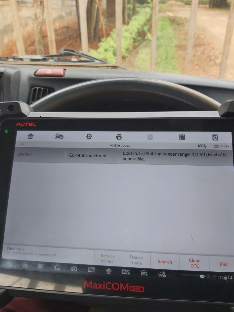

Hey?am trying to fix mistubishi Canter duonic transmission shifting issues and all is invain.i nid some help here guys.check wiring and seemed to be 100% ok kindly what does this code mean?does this truck nid a computer update?

Found this just searching to find out what this thing is.
gearsmagazine.com/magazine/introducing-the-mitsubishi-dsg/
Looking at the shift pattern in figure 8 the 4th/1st/6th Shift rail moving to the rear is the what REV/1st/6th have in common but isn't required for any other gears.
Gears also did a follow up article which mentions that the shift rails are monitored by position sensors. Take a look to see if your scan tool can display shift rail PIDs. Might even have bi-directional controls for them if you're lucky.
gearsmagazine.com/magazine/heavy-duty-sh...-duonic-6-speed-dct/
