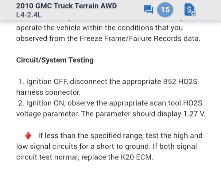

Watched a video Burnie Thompson ats he was working on a 2012 gmc terrain 2.4 l engine. He stated 02 ground bias on this vehicle supposed to be 1.25 volts on 02 ground. It has a convential 4 wire heated 02 sensor. Vehicle had a lower ground bias. Had a code p0171. Ending up being a faulty pcm. Great video. I have always seen 450mv on signal wire. Does anyone know if newer gms using ground bias plus 450mv on signal?

Bernie shows tan/white should have a bias voltage of 1.25 volts or the 1.27 volts. Wonder if the 02 signal wire has a bias also and the voltage amount.

I imagine just a ground bias.
