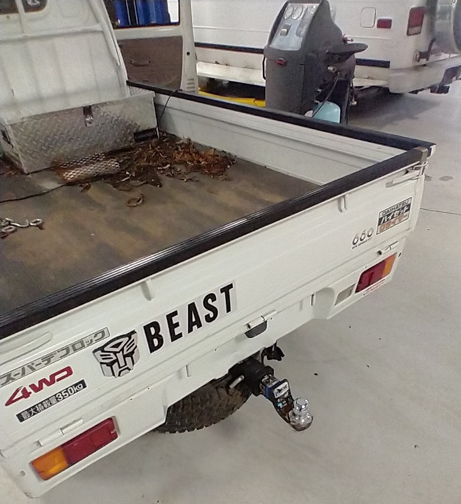

Teammate has a Daihatsu Hijet in his bay, complaining of no A/C. We've charged it, and there's still no compressor engagement. Compressor engages with 12V applied to the clutch. Someone has already been into the HVAC control head with wire nuts...
We desperately need service info for the A/C system, but Mitchell and IDFix don't have jack for this thing. Which makes sense, since I'm pretty sure this thing was never sold in North America. Can't punt it to the dealer, because, well, there is no Daihatsu dealer. :silly: So how did it make its way to Kansas? Great question.

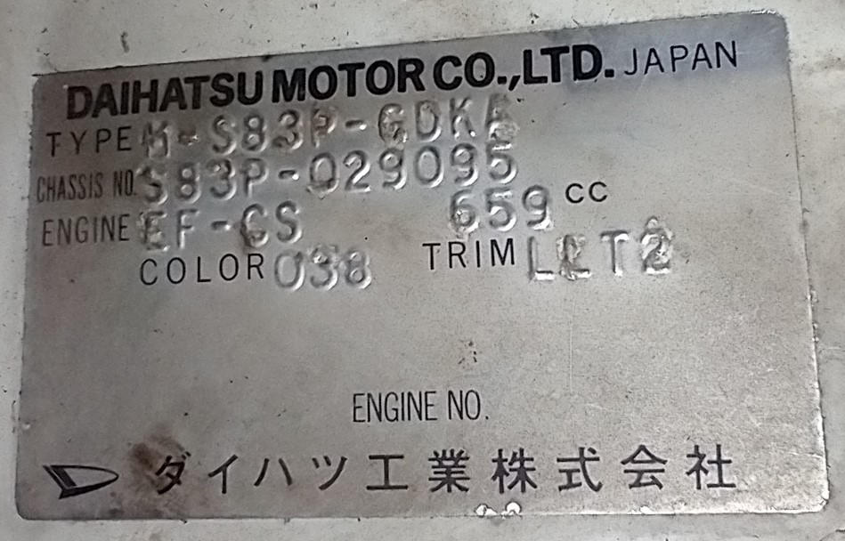

We're not even really sure what model year it is. :blush: I grabbed some pictures of the closest thing I could find to a VIN plate:
Don't ask me about the Transformers thing - I got nothin'. :silly:

That's a hijet mini truck S83P i found a service manual but for a S84 with no A/C
