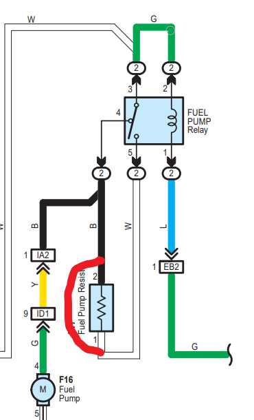

6 years 2 months ago #42054 by Tyler
Replied by Tyler on topic Lexus 2006 RX 350 . Will not run at idle
Got some follow up for this one. Could use a second or third set of eyes from the big brains around here.
Talked with Paul last night, and made the suggestion to jumper across the fuel pump resistor connector. With the jumper installed, the vehicle idled for an hour, no problems.
I Painted the OE diagram because it's (strangely) easier to understand than Mitchell :silly::
Any reason not to replace the resistor?

6 years 2 months ago - 6 years 2 months ago #42073 by Matt T
Replied by Matt T on topic Lexus 2006 RX 350 . Will not run at idle
Tyler wrote: Any reason not to replace the resistor?
Was the resistor ohmed out? Found a listing on ebay which shows 0.32 ohms printed on it. If the resistor doesn't show high resistance I'd dig a little deeper.
Search ebay for 274241968193. :angry: forum software :angry:
Whether it's worth the cost and delay to replace it depends on vehicle condition and use. If the idle fuel trims look good with it bypassed, and it hasn't set any codes, maybe making a bypass with the resistor pigtail is good enough? Think I've been watching too much PHAD :lol: :silly:

6 years 2 months ago #42076 by Tyler
Dtnel wrote: And who would’ve thought all that coloring as a kid would’ve paid off... :P :P :silly: :silly: :P
Marketable job skills! :silly:
No ohm testing, we were just pumped that the stupid thing ran. :lol: If it were my Lexus, I'd permajump it and call 'er done.
Paul let me know that they actually found some wiring damage near the resistor. Don't know if it's on the resistor side of the connector, or the harness side. :unsure: If it's on the resistor side, the test was valid. If it was on the harness side, then... I'm confused. He's going to send me a picture.
