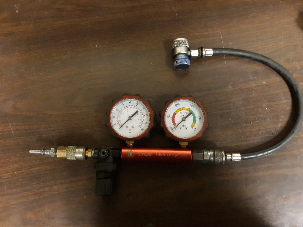

That's perfect, I just happen to have one of those laying around, I'll do high pressure smoke. And soapy water at the same time. Good ideas. Thanks all.

Yeah I don't have access to ac equipment at the moment, so I'm just going to put shop air in and look for bubbles.
