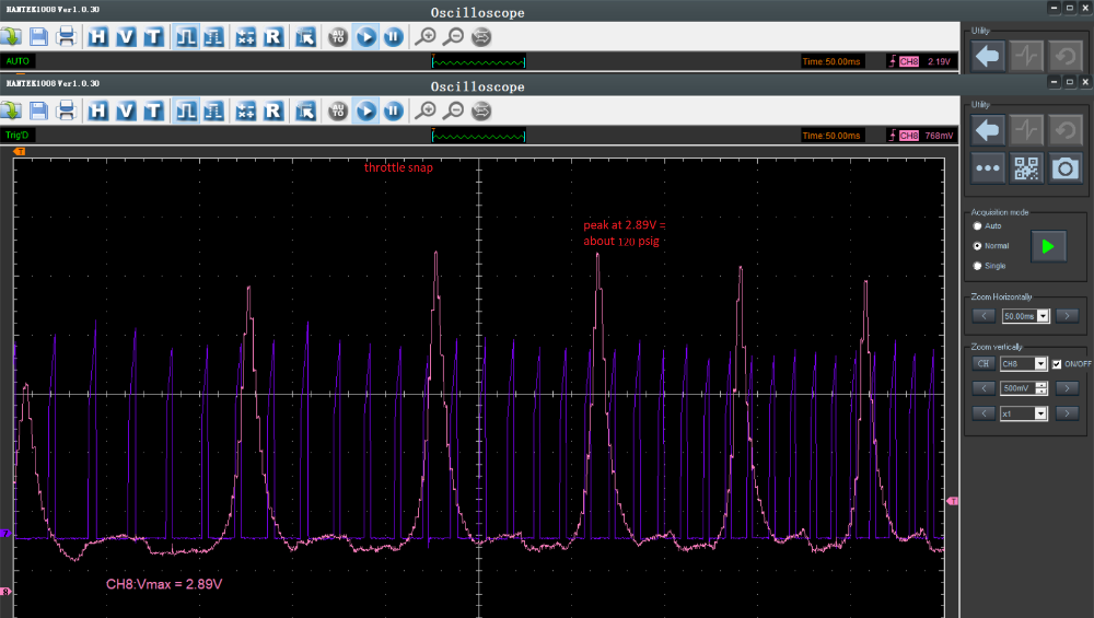

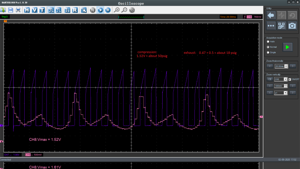

6 years 2 months ago #42727 by mdce4
Here are some trends for the in cylinder pressure transducer engine running test, snap throttle. I attached a trend for bank 1 cylinder 3 (looks good to me?), and a trend for bank 2 cylinder 4 (bad side).
I have no experience interpreting these kind of trends, but even i can tell that Bank 2 looks horrible. I also tested another cylinder on bank 2 and it looked just as bad.
So, i removed the O2 sensor on B2 and connected a gauge for exhaust back pressure test, and on snap throttle, the gauge was pegging out at 15 psig. I did the same for B1 exhaust pressure, and the gauge stayed at 0 the entire time.
So, i guess i'm dealing with a plugged cat on B2, but is the misfire caused by this blockage on B2, or is there still another issue going on?
