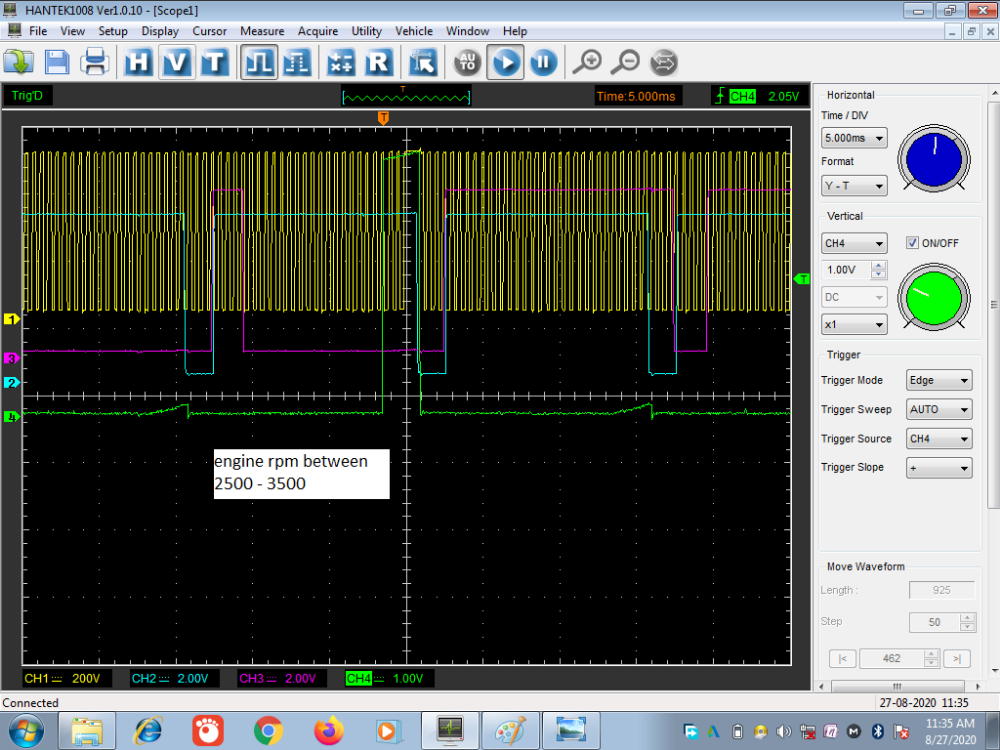

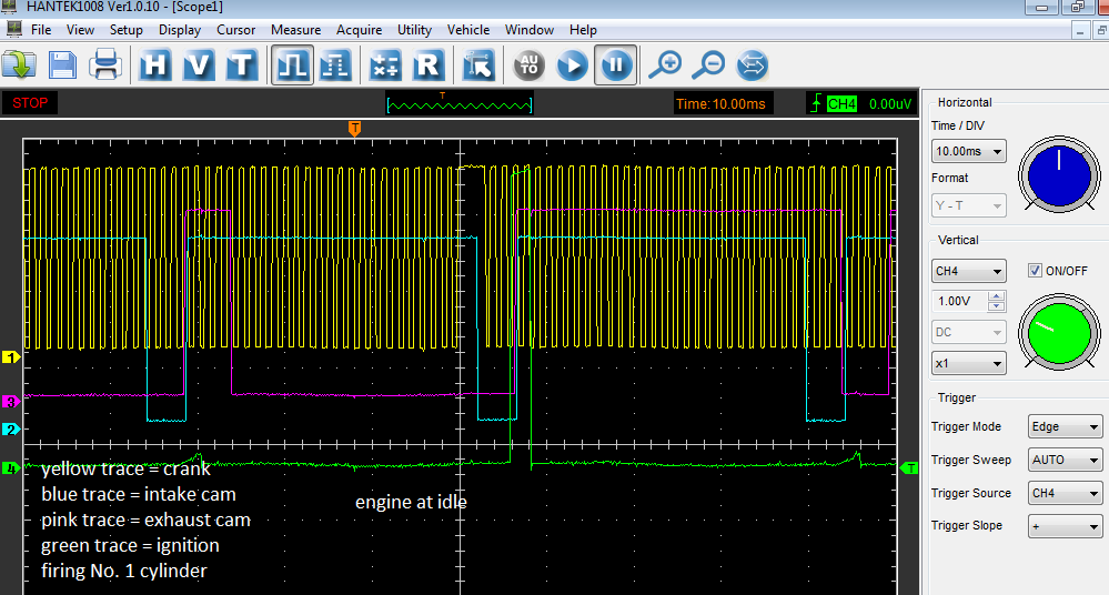

6 years 2 months ago #42575
by sagir.iliyasu.adamu
Replied by sagir.iliyasu.adamu on topic HONDA 08 VERY POOR FUEL ECONOMY
Hi everyone, I have now taken care of the P0011dtc by replacing the camshaft actuator with a used one and then got P1009 dtc which was also taken care of by cleaning the vtc solenoid valve and the screen.
Also there was a P0138 that was taken care of, it happened that one of the 02 pins was not fully connecting in the connector. So now there was no dtc related to engine after been driven for 2 days.
However, the Map reading is still high getting between 34 - 60 kpa, I have swapped the Map sensor from another car but still was getting the same result, so Map sensor is not the issue.
Please I have attached some pictures of cam-crank signal when the car was running and seems the ignition timing was changing and also the cam-crank correlation doesn't seems to be correct when compared to known good I came across.
Could it be the timing chain is shifting when engine is running.

6 years 2 months ago #42664
by guafa
Replied by guafa on topic HONDA 08 VERY POOR FUEL ECONOMY
I cannot see any change in cam/crank correlation and spark timing could be related to emission control (if don't change load conditions).
Map readings could be related to engine temp out operation point, wear in valve seats, dirty egr valve, open evap valve, broken hoses.
Can you post new PID's with after changes?

- sagir.iliyasu.adamu
- Posts: 6
5 years 8 months ago #46682
Still on same car, someone can help me analyse these in cylinder pico capture and tell the problems. I am inexperience and so still learning.
