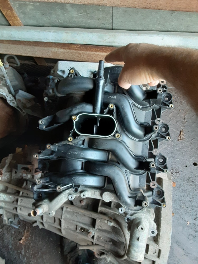

2010 Ford 5.4 triton, Upstream sensors are a wide band and downstream are narrow band I have to be sitting there WOT to keep it running watching my upstream and downstream both indicate fully lean Wide bane o2 2.5 @ wot downstream are at .02 Indicating super lean
My fuel pressure at the rail is 50 psi koeo ,60 psi koer
When the truck does manage to go to closed loop the LT trims Are maxed out high but the system keeps forcing into open loop Not sure where to go from here.....

Unfortunately, I can't make out the pictures of the codes you posted.
Did you check it for a vacuum leak?
I remember a great big rubber elbow in the back of the intake nearly impossible to reach on some of the 5.4l engines that would come apart (or be left off :blush: :blush: :blush: ), and the truck will barely idle.

Let me know if you can see these pictures, I suspect a huge vacuum as well

Pictures suck P2195 P2197

Well I believe I found my problem mass air flow sensor, at 200 rpm,ram, its reading 50 gm/s lol I knew I had a super lean issue the engine thinks there's a whole lot more air coming in then there actually is
If I snap the throttle the gm/s shoots up to over 100

200 RPM? That thing really is running like crap. That's about cranking speed...
Be sure to let us know if the MAF fixes it.

Nice find! Good job
