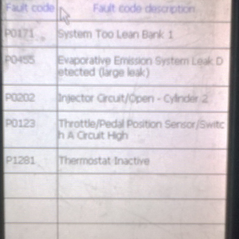

The ram is back the oil pressure is fine and truck seems to be running fine but the engine light is on. I pulled codes on it and get p0171, p0455, p0202, p0123 and p1281. The truck needs to pass smog in California, here is the freeze frame code and pending code all help is greatly appreciated thank you.

This is potentially 5 completely separate problems, and I would tackle each one individually. Maybe start with the injector fault code. How does the truck run? Is there a misfire?

I say you should feel free to skip the P1281 and P0455 for now. It'd be cool to tie the lean code and the injector together, but they're on opposite banks. :(
I'm with Dan about chasing the injector code first. Does this have a remote start? I see those crappy ScotchLock connectors causing injector codes all the time. :angry: The running rough in the morning, and the cold ECT in the freeze frame, kinda makes me wonder about leaking intake runners...

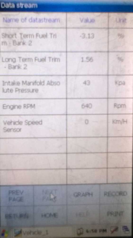

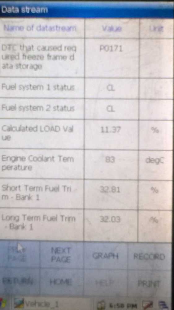

I thought similarly on tying the P0455 and the P0171, but this being a speed density engine it is doubtful. In fact, i highly doubt that a vaccuum leak is playing a part in any of these fault codes, though it could be contributing to the roughness on cold start. A purge solenoid that was stuck open or any vaccuum on this setup would be expected to cause a high idle, and subsequently a P05 series fault code, and wouldnt have a hige affect on fuel trims. Knowing Chrysler, I'd be willing to bet we have some sort of an oxygen sensor issue contributing to the P0171, though I'll admit this is purely speculation with no founding on applicable data. Speaking of data, think you can get some captures? Particularly fuel trims, loop statuses, and oxygen sensors to see what we are working with.

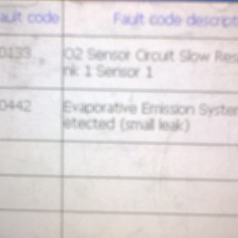

Hey Tyler I'm happy to say that the oil pressure is good thank God. This truck has no remote start, pending codes are p0133 and p0442. I checked the injector and I have battery voltage when running and pulse on signal wire. I do hear the injector,I also did a cylined drop test and hear no change on cylinder 2 I do have good spark. Cylinder 4 drop test truck almost stalled. I have a External Multiscope but I don't know how to set the settings to get a good wave pattern.

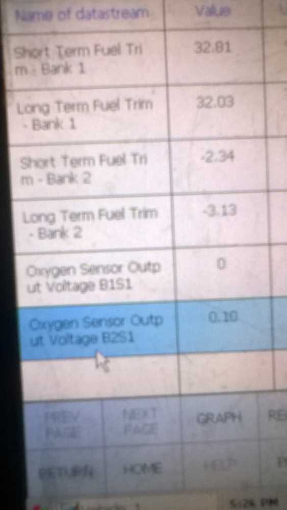

SniperDan i took thees shops of the injector hope this helps. I was also looking at long and short trims with o2s and i noticed that bank 1 sensor 1 was not working. From experience i know that the o2s on thees truck can cause a lot of problems I'm going to replace the o2s and see what happens.

Is that B1S1 fixed lean all the time? Before replacing it, I would do signal circuit testing to confirm that signal is not shorted to ground. Simply unplug the sensor, and your scan tool should indicate 5v on this design. As for the other captures, I can't view any of them. Is there any way you can insert instead of attaching?

I would also add an alternative fuel source to the engine and attempt to drive this signal rich. We need to determine if this is an actual lean condition or if the O2 actually has a problem.

So I checked and replaced the 02 sensor and fuel trims are good thank God. As for the po455 the fuel cap was leaking. Brother I did insert the pics but they did not show up then I attached them and same thing.
