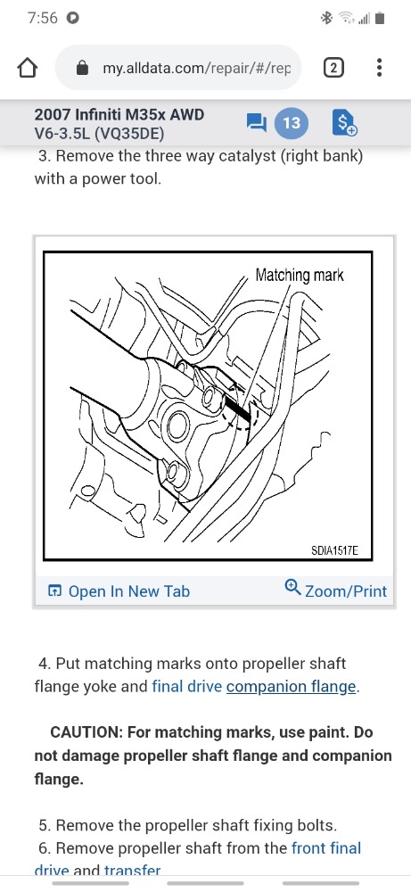

6 years 2 months ago #42516 by Ccglenn
2007 infinity mx35 front drive shaft was created by Ccglenn
I have the old one out because it came apart, I have the right converter out , I was UN able to get the new one in so far looks like steering rack lines in the way, looks like I’ll be taking half of the car apart, I couldn’t find a labor guide on this job either anyone hints
6 years 2 months ago #42518 by Noah
Replied by Noah on topic 2007 infinity mx35 front drive shaft
I've never done one, but All data says remove cat, remove shaft.
Nothing about the rack or lines.
