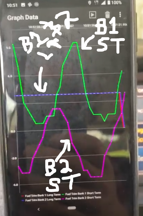

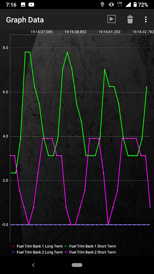

But in between I come to where I am now. Perplexed by this: My STFT on Bank 1 are higher than Bank 2. Not enough to throw a code but definitely higher. And yes maybe it's due to no cats which hopefully will resolve something with that today but I'm feeling like it will not.
A clearer image of this happening:
I made a video. This starts with me idling in the driveway and going on a 10 minute-ish drive with a little revving in between. At times it will stablize and the STFT for bank 1 and 2 will be in unison (obviously opposite each other) which is what I figure it should be.

Your trims look fine, anything under 10% or over -10% is considered within an acceptable range. It's common for one bank of an engine to have a different trim than the other bank and any number of things can be a factor to change the fuel trim up or down a few percentage points.

Okay so one STF is averaging around +5 the other on around +2 --- nothing crazy there but what you have to look at is the the sum of the STF and LTF for each bank, anything under plus or minus 10% is considered OK. Looking at the pattern of the the STFs it looks like the upstream O2 sensor are working fine but if you want to to confirm look at the graphs of B1S1 and B2S1
