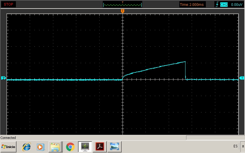

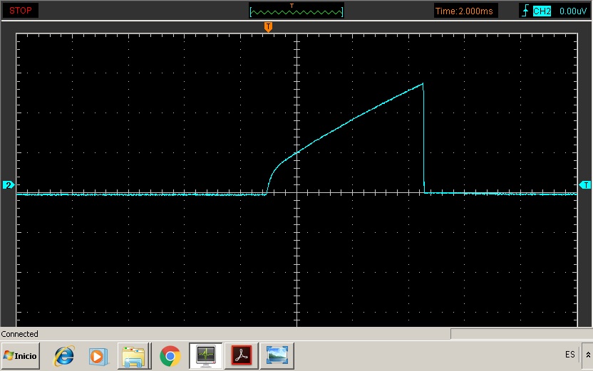

[working in a 98 mitsubishi galant , misfire problem , when i put the clamp with oscilloscope and measured the primary current , i saw this
i think its a primary shorted [/b ] ¿what do you think guys?
Last edit: 9 years 8 months ago by yhspeed.
9 years 8 months ago #5575 by SniperDan
Replied by SniperDan on topic coil problem
It has the characteristics of a shorted secondary winding. Typically a shorted primary would be much more severe, with pretty much no ramping due to the lack of CEMF. Almost as a high amperage square wave if you can envision that.

9 years 8 months ago #5580 by Dylan
Replied by Dylan on topic coil problem
SniperDan wrote: It has the characteristics of a shorted secondary winding. Typically a shorted primary would be much more severe, with pretty much no ramping due to the lack of CEMF. Almost as a high amperage square wave if you can envision that.
Exactly!

9 years 8 months ago #5582 by ScannerDanner
Replied by ScannerDanner on topic coil problem
SniperDan wrote: It has the characteristics of a shorted secondary winding. Typically a shorted primary would be much more severe, with pretty much no ramping due to the lack of CEMF. Almost as a high amperage square wave if you can envision that.[/quote
exactly! And with that waveform, I am surprised it runs at all
