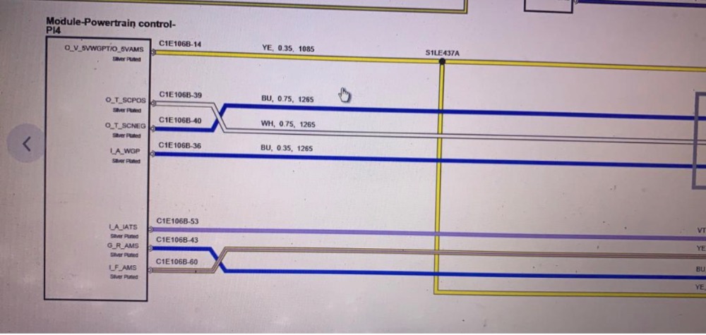

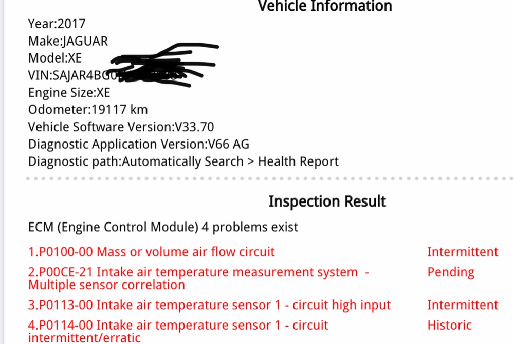

A friend of mine had this car at his shop and was trying to repaired it. He has changed pcm, and even changed MAF sensor but still problem exist...
Car won’t throw error code until you hold the accelerator down for some times before you get error codes talking about Maf and iat..
Intake air leakages were checked and all seems fine.
Need some help on this,
The 5 volt reference comes when car start and accelerator pedal depressed... attached file contains images of the fault codes and the wiring diagram..
The car stalled when the sensor is plugged but when it is unplugged car won’t stall...
I have helped him to look for leakage but no leakage, I need help

6 years 2 months ago #42588 by Hardtopdr2
Replied by Hardtopdr2 on topic 2017 Jaguar XE 2.0 Turbo - MAF & IAT error code
Back probe maf and iat wires at pcm and write down readings then do the same at maf and iat sensor. After that unplug sensor and check readings again. Then ohm each wire with battery disconnected pcm disconnected and sensor disconnected. they should read zero. If everything checks out then check wire insulation going to pcm for bare spots ahorting to another wire. And check grounds for sensor and pcm. Problem should be in wiring otherwise it may be internal to pcm.

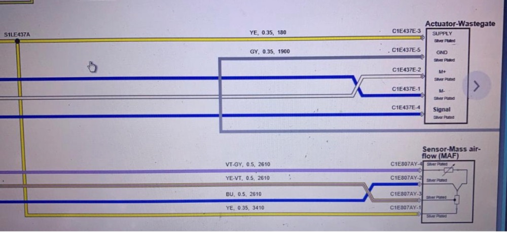

6 years 2 months ago #42590 by Matt T
The blue wire looks to be the one that could affect both IAT and MAF, and appears to be a sensor ground. I'd 'scope it at the MAF and see if it's getting driven high.

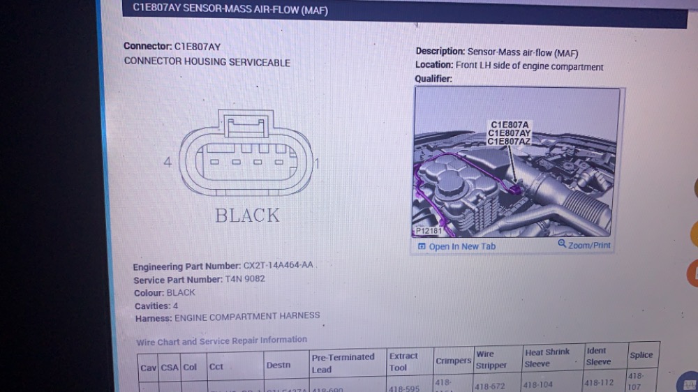

6 years 2 months ago #42605 by forumoto
With engine off, key on..
Pin 4 at Sensor side reads 12 volts but when car starts it goes on to battery volts, this test was done without Connecting the harness to the sensor, the pin 2 maintains it Ground/earth ( whether car start or not) , pin 1 also gives 5 volts reference as well as PIN number 3 also gives it close reading to 5 .

6 years 2 months ago #42609 by forumoto
The blue wire is contain ground which is there when car starts or not, the ground does not disappear, even when connected

6 years 2 months ago #42615 by Andy.MacFadyen
Replied by Andy.MacFadyen on topic 2017 Jaguar XE 2.0 Turbo - MAF & IAT error code
Looks like a wiring harness or connector issue to me. Also was the MAF genuine or known good ? ---- lots of fakes around

6 years 2 months ago #42640 by Matt T
forumoto wrote: for couple of minutes before error codes come up..
Do all four codes set when this happens?

6 years 2 months ago #42657 by forumoto
Yes please the codes all appear... or sets in... reading the live data of the Maf and iat, you can see that they re not responding well, another car MAF sensor was tried yet still, original sensor was taken to the other, it’s perfect
