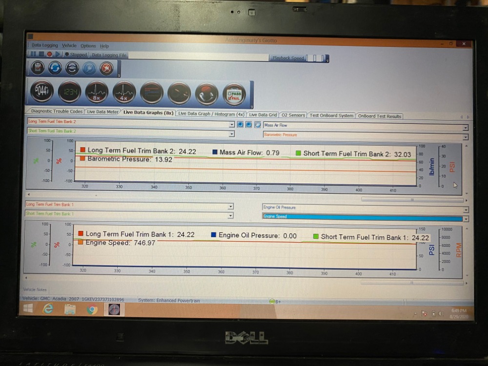

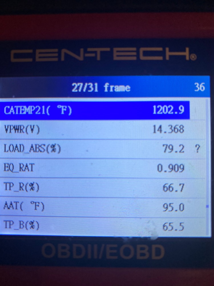

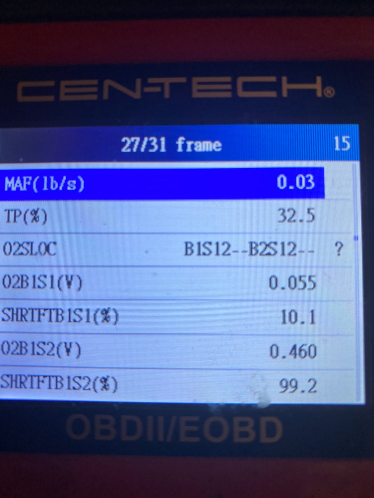

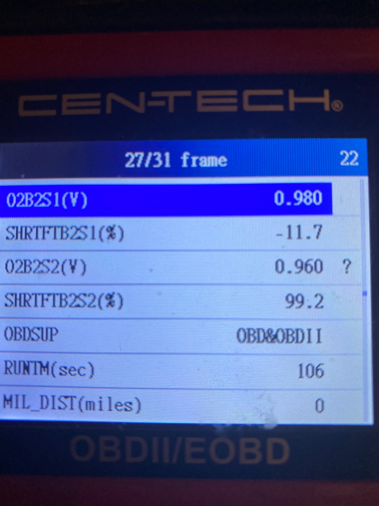

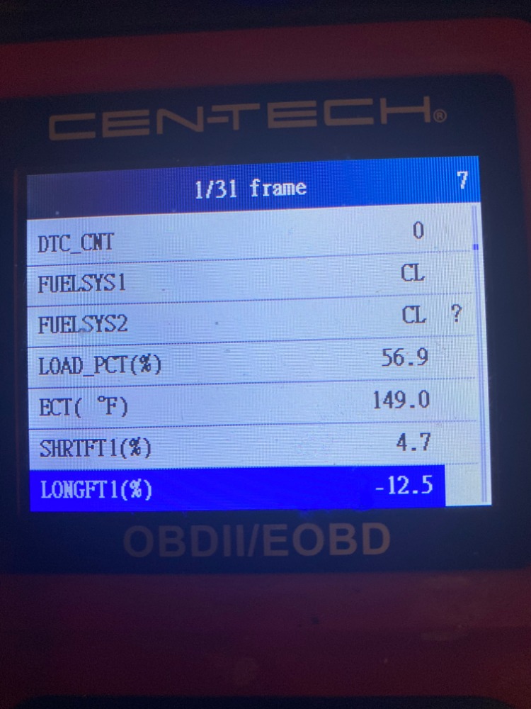

  • itsmerandy
  • itsmerandy's Avatar Topic Author

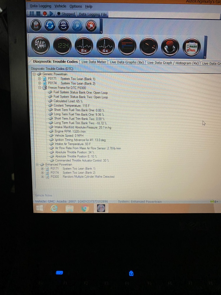

6 years 2 months ago #42621 by itsmerandy

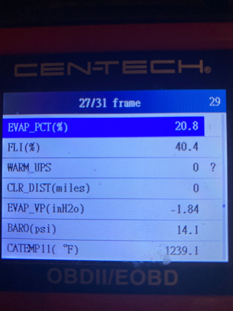

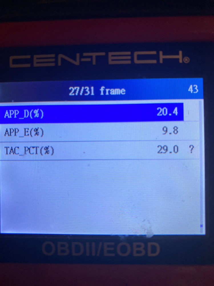

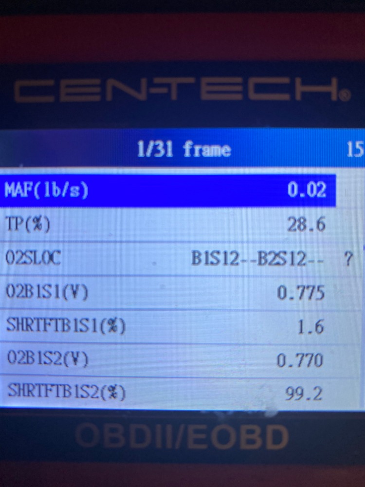

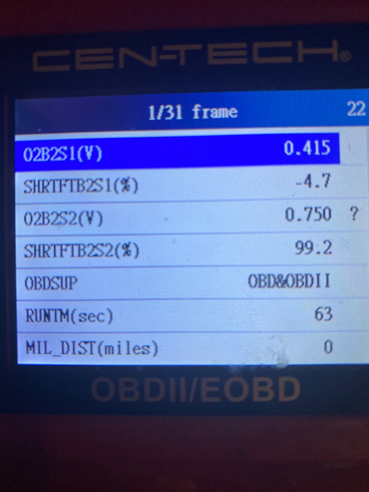

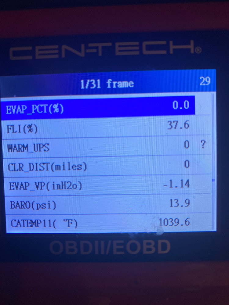

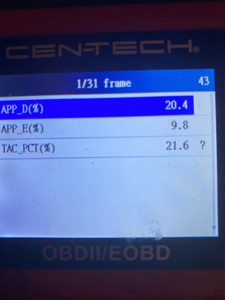

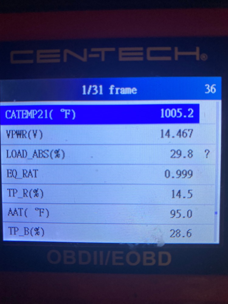

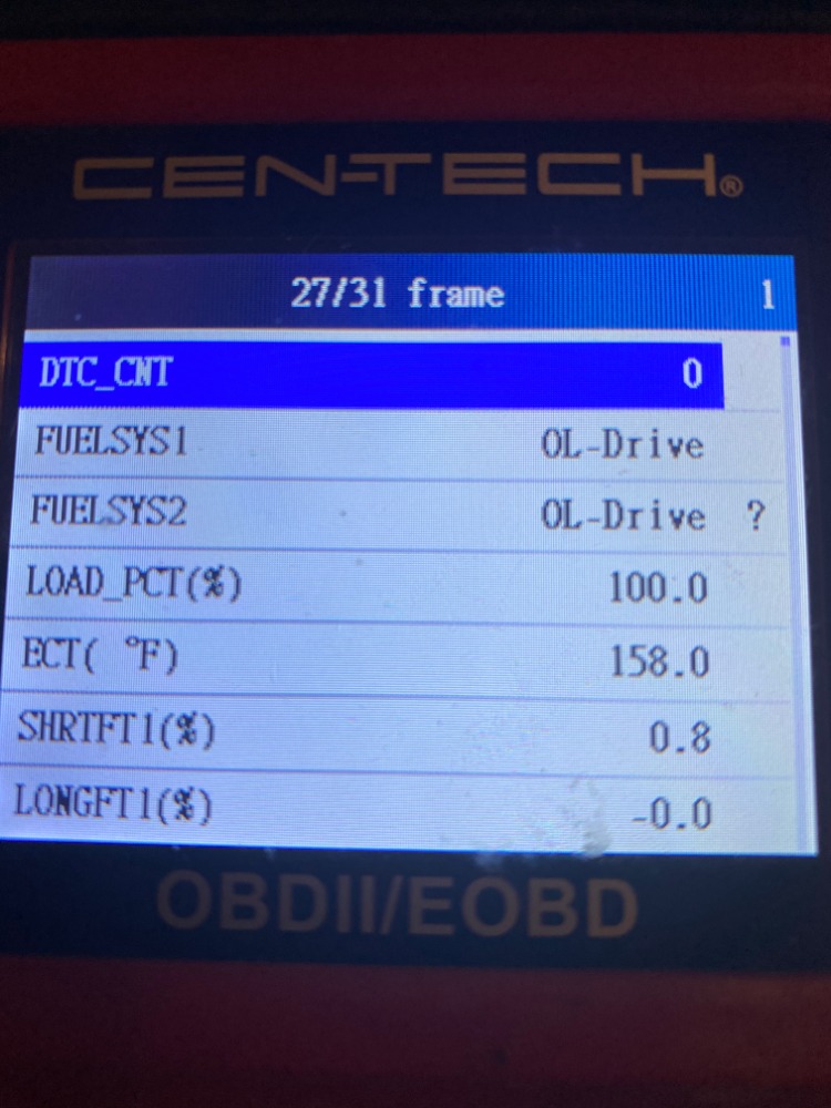

This is best I could do. It wouldn't start and run so couldn't record info with Giotto. But had this from friends code reader from couple days ago. Car has new MAF sensor, Fuel pump, timing chains and plugs. And only code that has came up for me is the P0300 random misfire. Sometimes it will act like it wants to start if I hold throttle to floor.

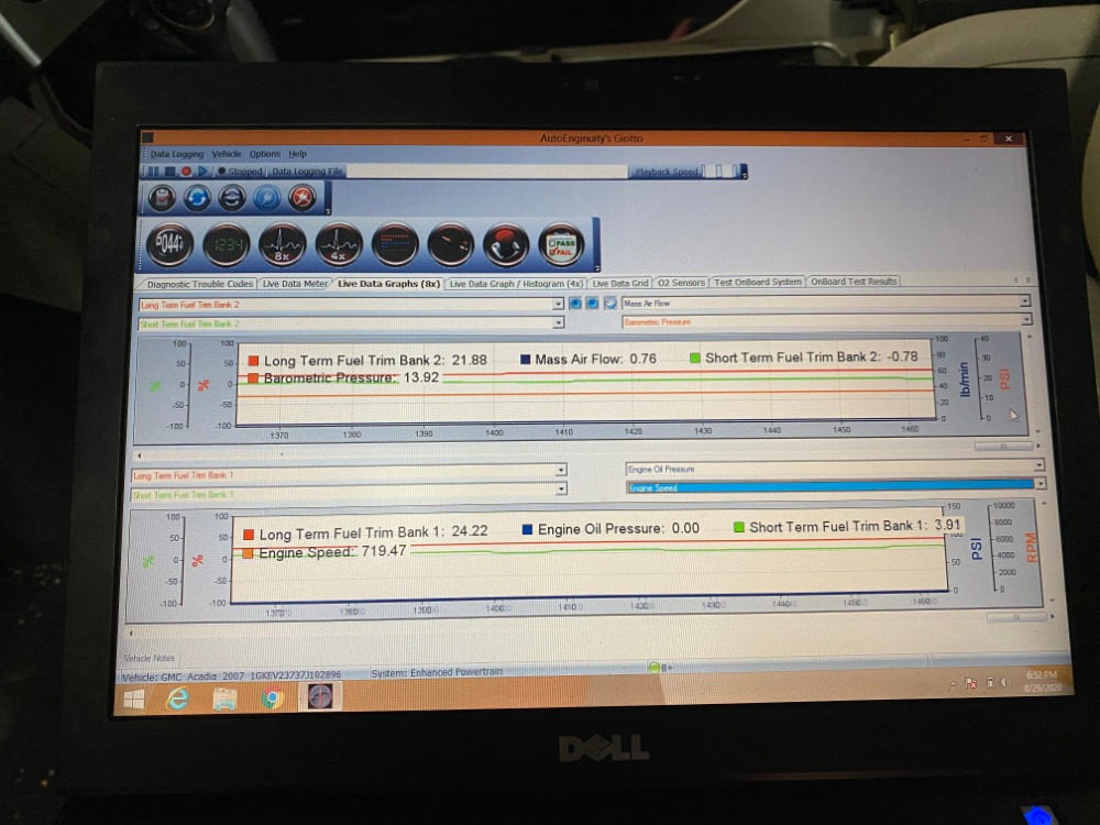

  • itsmerandy

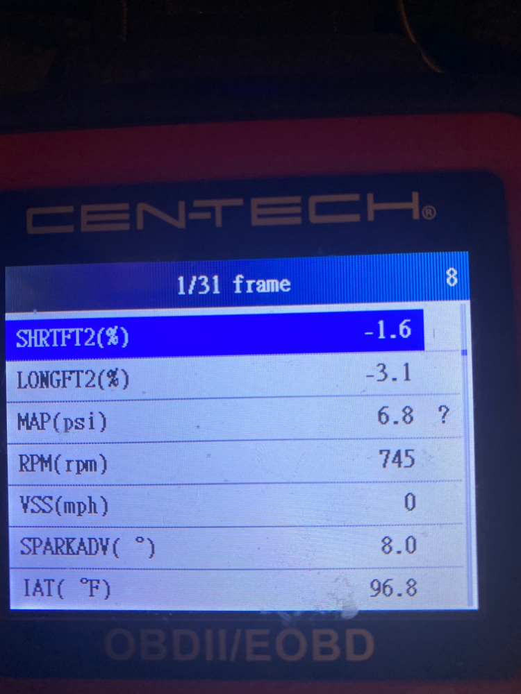

6 years 2 months ago #42622 by itsmerandy

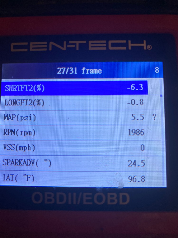

Here is 2000 rpm's -
6 years 2 months ago #42623 by Hardtopdr2
Are you in mountains or at sea level? Baro pressure being 13.9 has me curious as it is part of map sensor which reads 6.8. Also maf is reading 9 g/s which is a little high for a 3.6 liter.

6 years 2 months ago #42633 by Tyler
Thank you for the data captures. B) Can you use the AutoEnginuity to look at the misfire counts on the OEM data? I'm willing to bet you'll find high counts on just a few cylinders. I know that the code description for P0300 is 'Random Misfire', but it's rarely random. ;) GM's will set a P0300 for a dead misfire on one cylinder.
Looking at your data, my first instinct is exhaust restriction. It'd match your symptoms, and it's a pretty common problem with this platform. But it's also not the easiest thing to check for. :silly: Since it's not starting right now, have you tried adding some carb cleaner to the intake during cranking?
