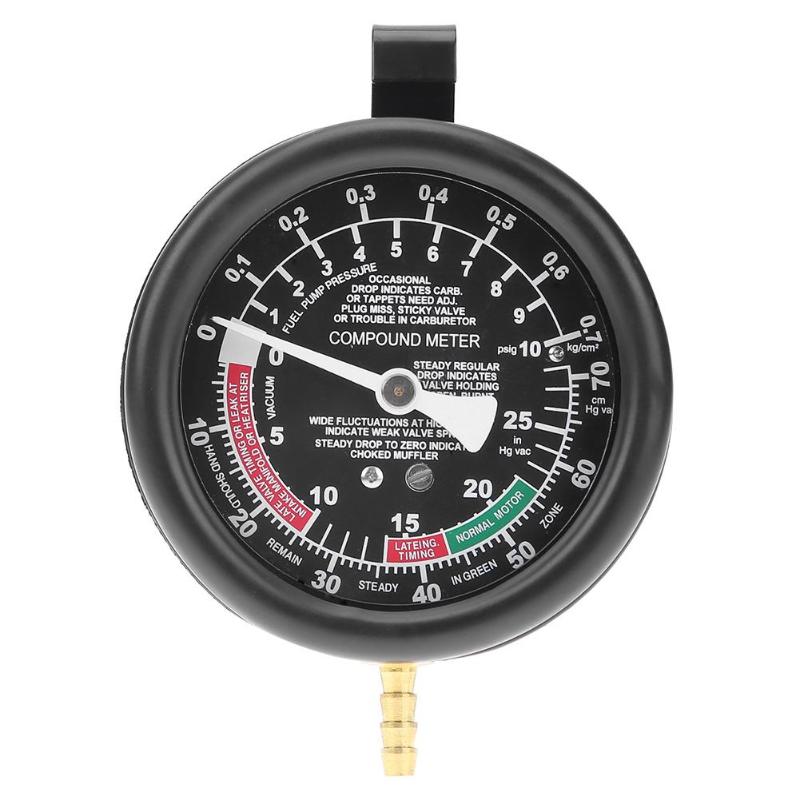

Fuel pre at idle 46-48. At rest with koeo goes up to 54 psi and holds. One O2 is Denso and the other is by Walker. Bought them from Rock Auto. Another thing, hooked a vacuum gauge and my readings at idle, not steady at times, is between 14" Hg to 30" Hg and vibrating real quick. At WOT, it reading from 10" Hg to max 30" Hg. Like I said before, I smoked the system and didn't see any smoke out to the atmosphere ,so, no vac leaks. Is there a possibility that maybe injectors are sticking open, interrupting the pulse width, only when engine is running? I'm just saying. I previously cleaned and ohm them, they all showed 12 ohms.

Ok with what this looks like is the fuel pressure regulator is stuck closed. To confirm it is stuck use a hand vac pump (mighty vac hand vacuum pump) and with key on engine off fuel pressure at ~54psi start applying vacuum and write down when the regulator starts releasing pressure. Then keep increasing vacuum and find when it stops releasing fuel pressure. If it does not release pressure then it is bad and the reason for the fuel trims being rich.

Now with the bouncing heavily between 14 and 30 inches hg this can be a valve timing issue. But we will dive into that after testing fpr.

I send you a message yesterday, 9-15 -20 and today, I can't seem to see it. Seems like it didn't go through. So, today, I'm going to send it again about testing the FPR. I cycled the key a few times just to get an accurate pressure of max 50 psi. Fuel pressure started dropping at 5"Hg and stop dropping at 40 psi and vacuum reading at 22"Hg. You, also, mention valve train problem like maybe a jumped timing chain. The scan shows 20 degrees adv. There is no valve train noise either. Chain is the O.E.
