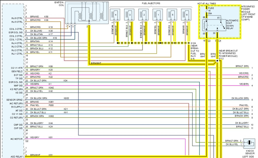

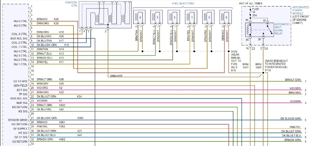

6 years 2 months ago #42724 by Donut
If the injector drivers in the PCM went bad, then it could keep the injectors from firing, but there are a few things to check to make sure that's the case.
The diagram below is pretty much the entirety of the injector/ignition coil circuit. They get all their power from the ASD relay and the PCM controls the ground side of the circuit. It starts at the top right with the fuse, then goes through the relay to the injectors and relay coil. The PCM turns the relay on, and if the relay is good those components will get power. And generally if the ASD relay was bad or not turning on when commanded it would set a code.

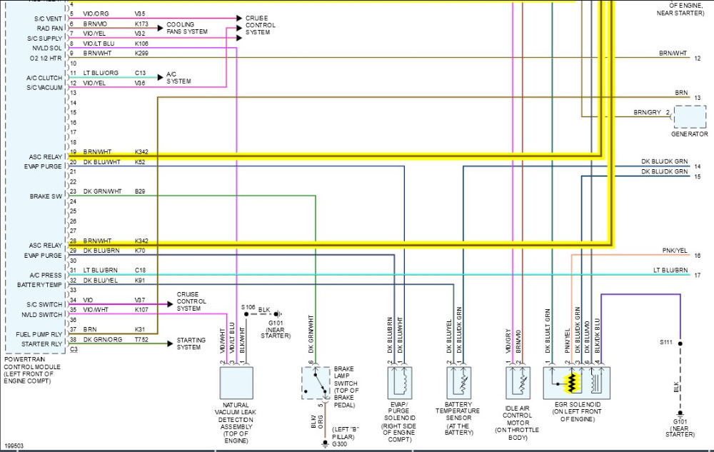

6 years 2 months ago - 6 years 2 months ago #42740 by Chad
Peaches wrote: Can you send me a diagram of these areas in question
Last edit: 6 years 2 months ago by Chad.
  • Peaches
  • Peaches's Avatar Topic Author
6 years 2 months ago #42741 by Peaches
Replied by Peaches on topic no start, ( possible) no power to injectors!!
Thank you Chad, for the diagram... and Thank you everyone who has taken time to read this and respond... Donut I'm put the PCM back in her.. just a little difficult when I'm not the one that took it out..Never messed with these before.. Wish me luck !!!

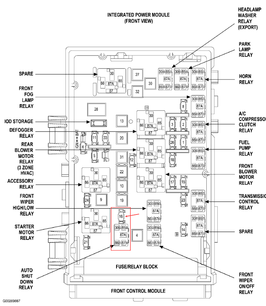

6 years 2 months ago #42761 by AguilarPro
Replied by AguilarPro on topic no start, ( possible) no power to injectors!!
You can try using a incandescent test light to test and see if the computer is supplying ground. To do this, you have to probe the control side of one of the wires and then touch it with the test light while clamped on battery positive (important), try to start the car, the test light should flicker if the computer is sending ground to the injectors. **Control wires are those that are different colors for each wire** Power wires are those that are the same colors for each injector.
Switch the test light to battery negative and now probe the positive side and touch it with the incandescent test light, it should illuminate (I believe you have to have the switch in the ON position for the ASD relay to complete the circuit), this means you have good power coming from the ASD relay. If there is no power there then check the fuse 16, if fuse 16 is ok, then the computer may not be completing the circuit for the ASD relay for some reason.
I have attached the screenshot to check the fuses marked for power, they both should have power when trying to start the car after the ASD relay.
