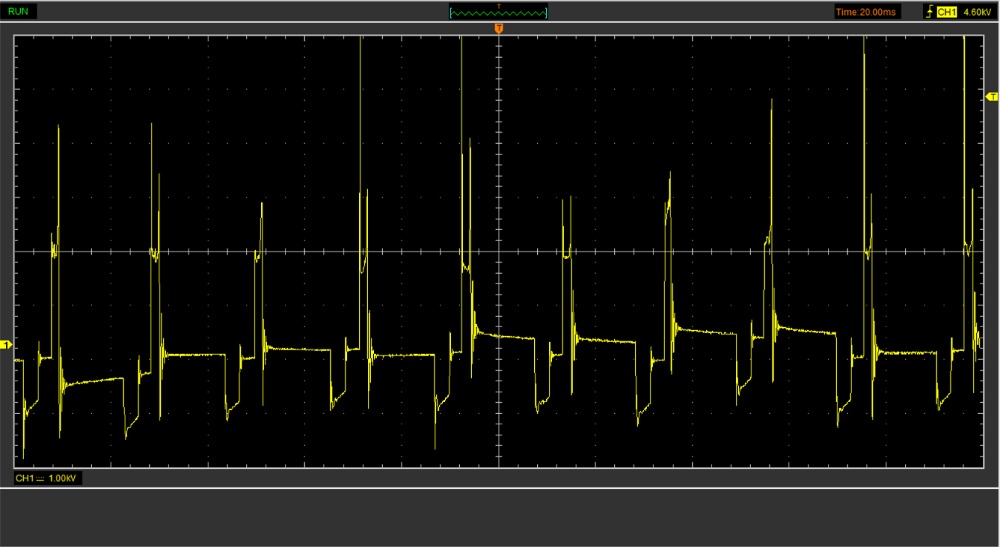

I got a waveform anyway covering all 8 cyclinders at warm idle (attached) and I don't see any obvious problem with one cyclinder anyway, but can't do a snap throttle test easily without knowing which cylinder i'm looking at.

The sampling rate of the scope combined with the selected screen time does not allow for an analysis of the ignition wave form......

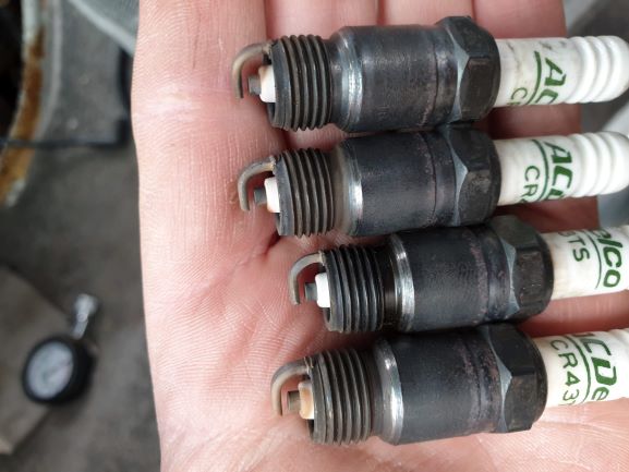

Thanks for your inputs so far. Took me a while to get back to looking at this again, did around 1500 miles in the meantime with zero issues.- Pulled the plugs on the rear four cylinders, checked the spark plug condition and then compresison tested all 4.
Pressures were
Cyl 5 (dead miss) and 7 (ok): 205psi
Cyl 6 and 8 (both ok): 180psi
The plugs all also look fine, far left is number 5, slight browning but others also showed evidence of this. Previously the number 5 looked a little wet, but this was after a lot of idle as opposed to now after a lot of motorway miles.

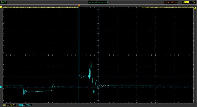

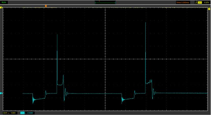

- The suggestion of using a timing light pickup was great, I realised I actually had a clamp like that for an old multimeter and it works perfectly, can now get the seondary waveform with a trigger! No idea why the amp clamp didn't show anything similar. This is waveform at idle
Comparing against the next cyclinder I don't see anything too extreme

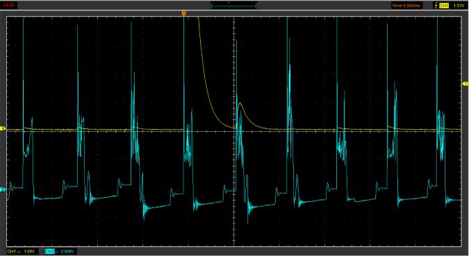

And under snap throttle
I also checked and double checked the plug wire and it is on securely and the plug definitely fires outside the cylinder. So it seems I have ruled most things out, again! Thoughts on the waveforms appreciated....
