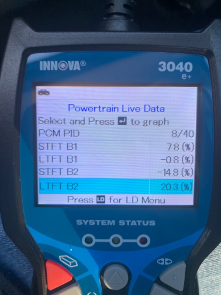

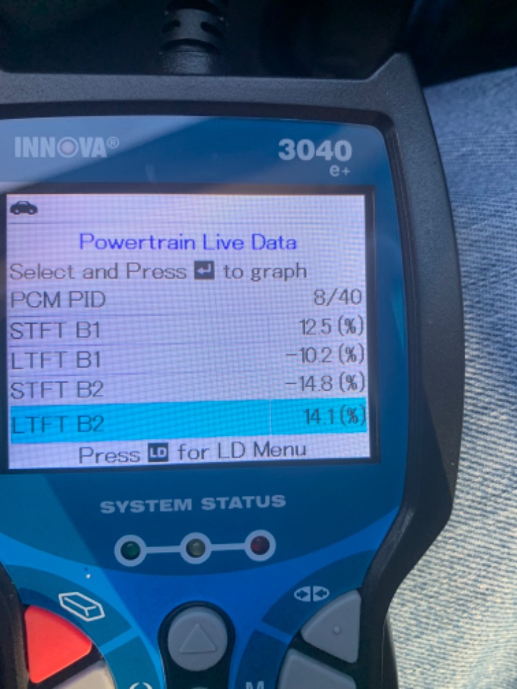

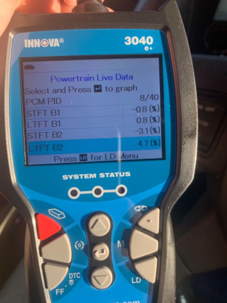

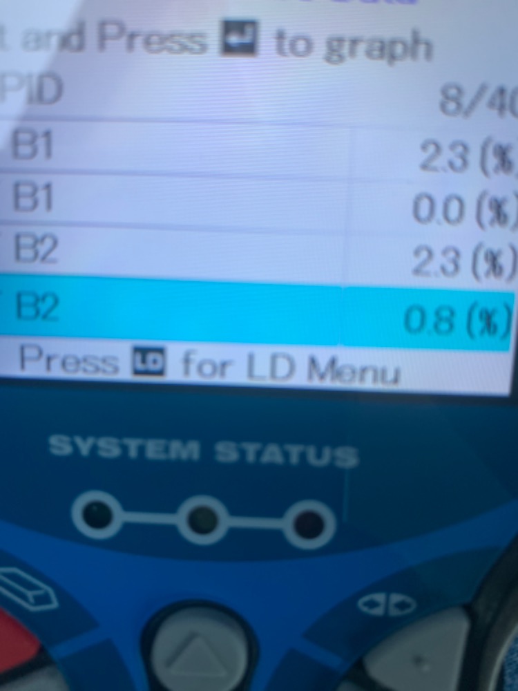

5 years 11 months ago #43046 by Nyc2nc82
Replied by Nyc2nc82 on topic Jeep sputter after warmup
Thank you both for taking time to help with this.
It was doing the chugging before I switched the injectors. I did have an injector code pop up once before the switch but it was mainly p305, 304 along with 300. Now it’s the 200 codes with p300.
I did drive it today, first 15-20 miles it was driving perfectly fine. The fuel trims were in the mid 20s and would drop into the teens giving it gas. Even dropped to 0 at WOT. No stumbles while driving or any chugging when I came to a light. Stepped in the store for about 30 minutes and when I restarted the Jeep it was doing the chugging and the RPMs jumping. If even stalled on me.
I gave it gas and it helped me to get going. Got the live data going while it was having the issue and bank 1 ltft was -0.8 and the ST was +7.8 but bank 2 was ltft +20 and the ST was -14. Bank 2 was in OL-Drive then went to CL. The more I drove and got to the highway it seemed to clear up and the fuel trims started going to normal ranges. Had a couple small stumbles while driving but they went away and by the time I got home the fuel trims were around 0-3 both LT and ST. Even let it idle a couple minutes and they stayed in a good range.
I checked the codes and the pending p171, p174, p131 we’re gone. I had stored and pending p300 and the 200 codes with the evap codes were still in there as stored codes.
Would a vac leak be this intermittent? Is it possible there’s another part like PCV or EGR causing it?
Sorry for the long post, trying to give as much info as possible and hoping I’m not confusing anyone. Thanks again!!
  • Nyc2nc82
  • Nyc2nc82's Avatar Topic Author
5 years 11 months ago #43047 by Nyc2nc82
Took a couple pics of the trims while I was driving after it started chugging and as it improved
