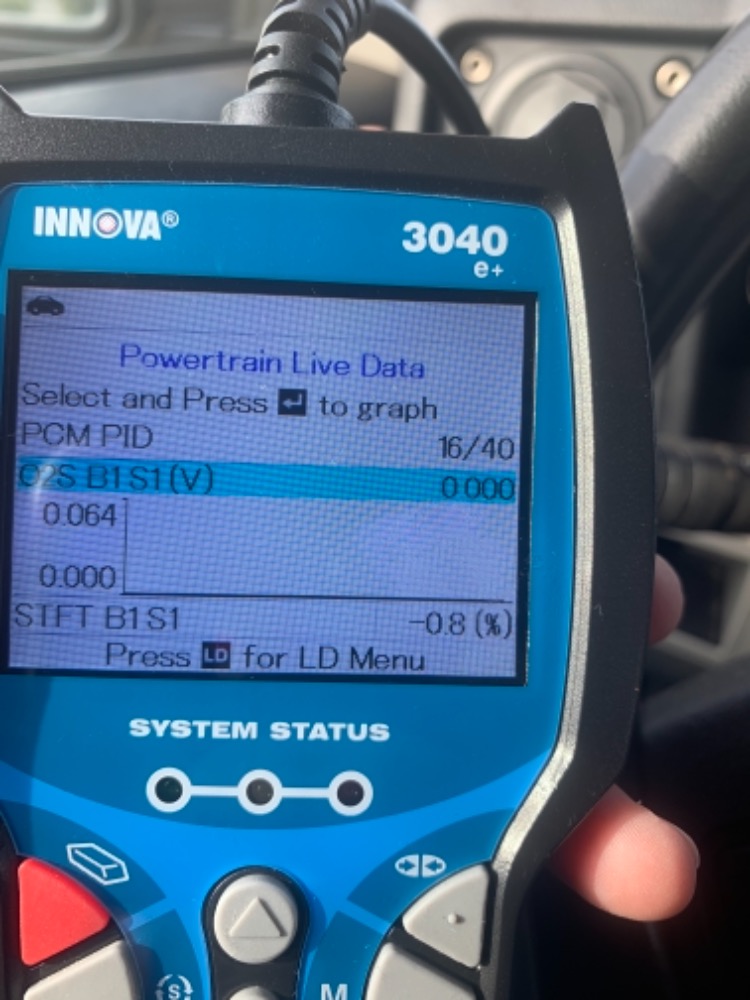

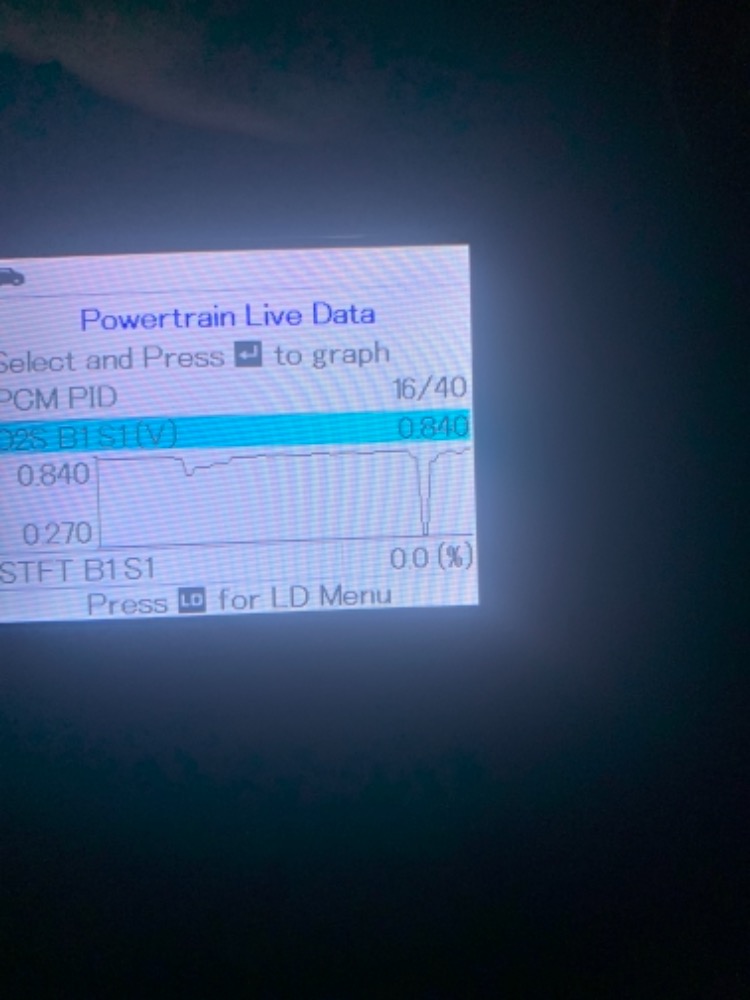

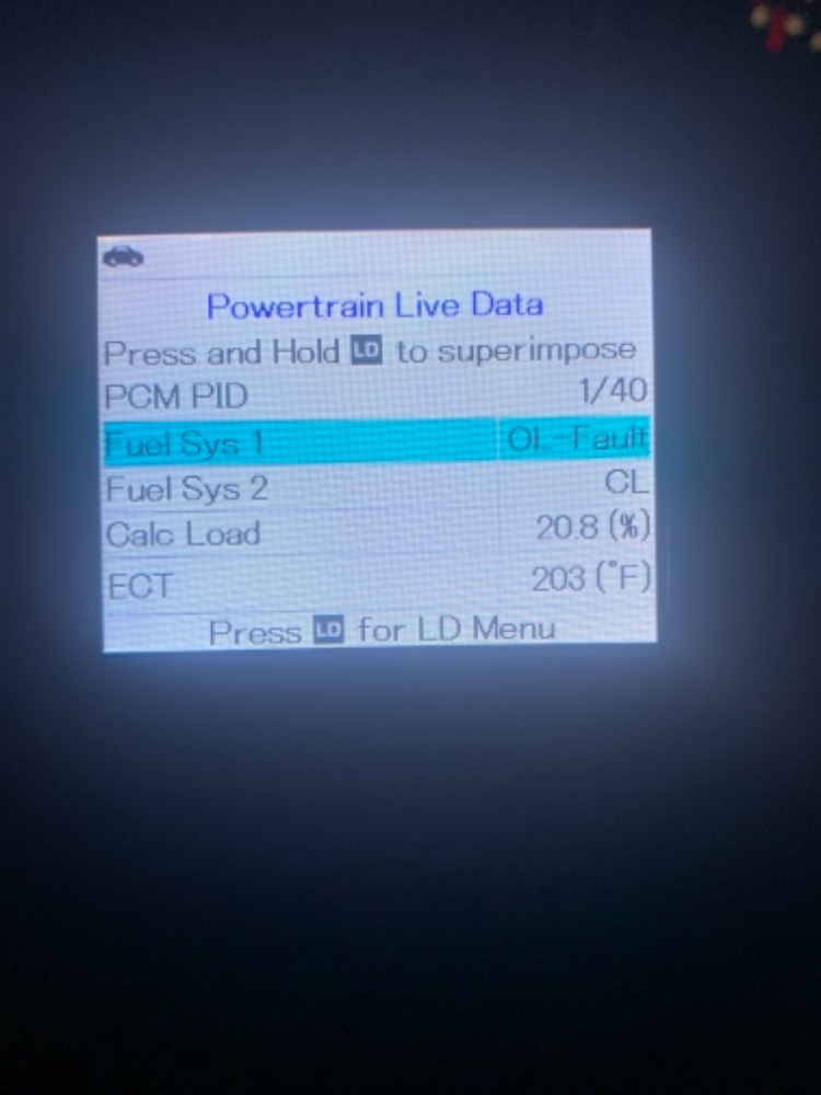

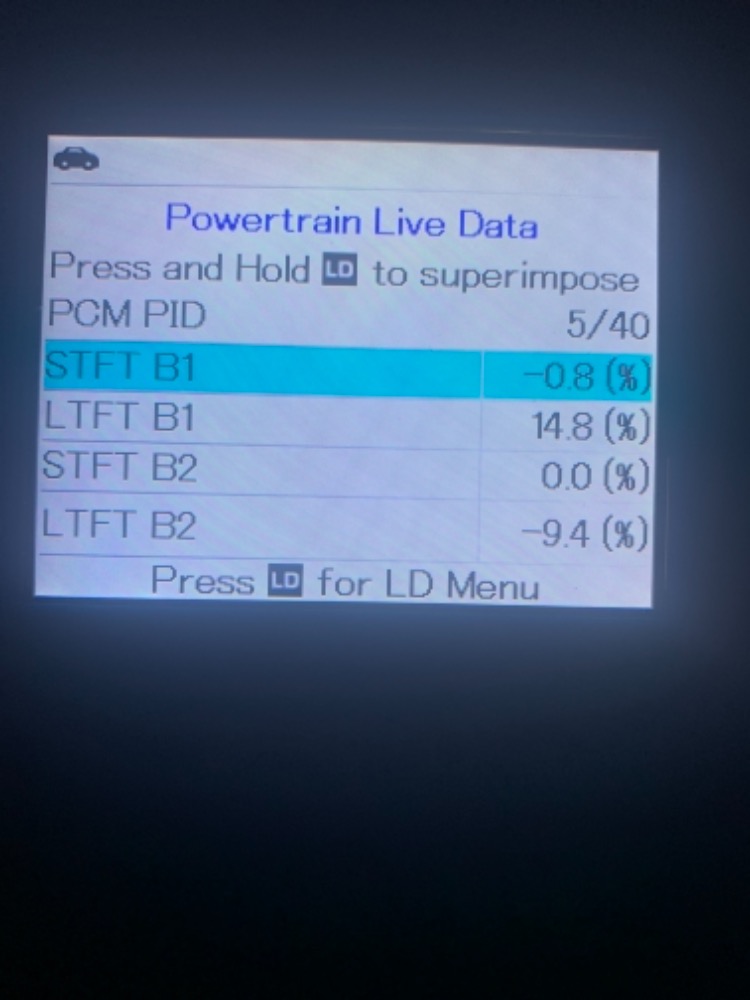

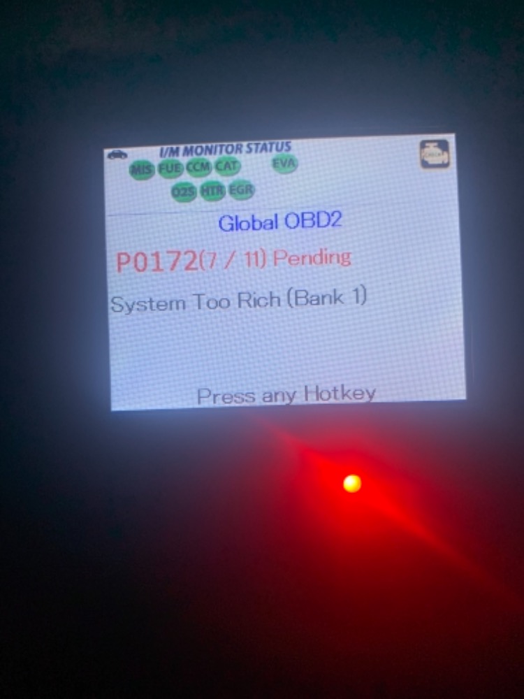

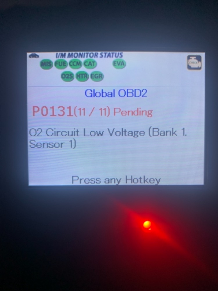

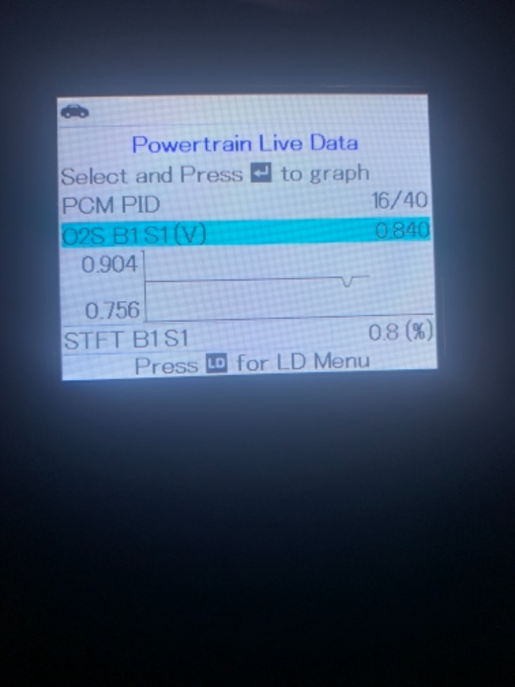

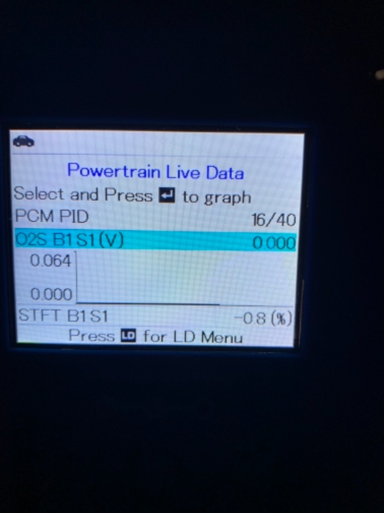

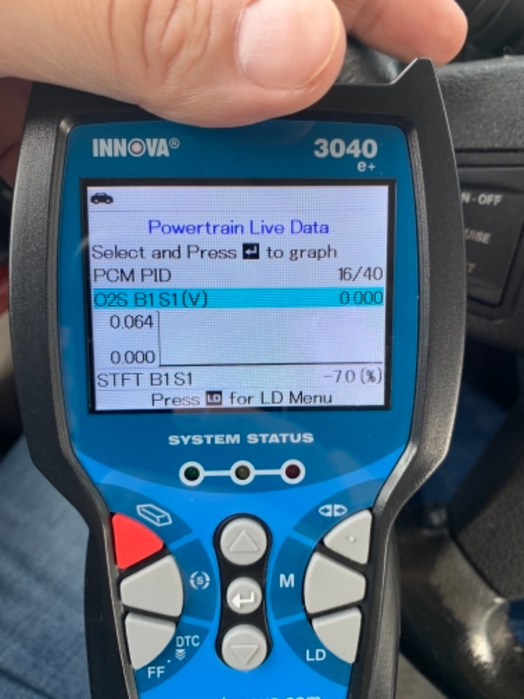

Connections seemed pretty secure to me. Have not opened up the harness, honestly pretty nervous to do so.
I do want to point out it’s been pretty cool the last couple days and have not had much of an issue with it. Only did a little bit of chugging after driving for quite a big big it cleared up pretty quickly.
The fuel trims actually looked pretty normal most of the day keeping around 0. They stayed fine most of my way home this evening but noticed bank one was at about +14 at idle when I got back
Flipped around the live data and saw bank one was open loop-fault. And when I looked at the o2 sensor it was a flat line most of the time.
I was able to get it to move while snapping the throttle but it would just go back to almost flat. I did have p0172 bank 1 too rich and p0131 o2 sensor voltage low.
I did not have any drivability issues or any chugging while this was happening. Not sure if it’s important but thought it might be worth mentioning

I think you need to replace that bank 1 sensor 1. It’s flat line rich taking all the file away on that bank. What does the rear oxygen sensor read on bank 1 when it’s acting up? Full lean or full rich like the front oxygen sensor

I’m thinking it needs to be replaced as well. They always seemed to be inconsistent but was not sure if that was the o2 going out or caused by another issue. Or both maybe. Bank 1 pretty much stayed flat most of the day, would seem to start working a little bit sometimes and seemed to be working at first startup but by the end of the day when I got home it stayed flat and would not respond to snapping the throttle. I do have both bank 1 too rich and too lean codes pending at the same time now as well

Haven’t spent too much time looking at sensor 2, but I believe it was about 6-800 while driving earlier today and was around 1-3 at idle when I got home today.

Just a quick update. I went ahead and cleared the codes a few days ago. Have been driving pretty heavy the last 4-5 nights.
I have not had the p200 codes come back yet. I keep getting p0131 o2 sensor low voltage, p300, p0172 bank 1 rich. Also had Bank 1 lean in pending on and off
