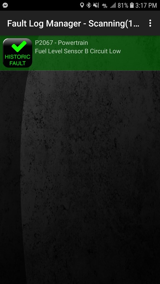

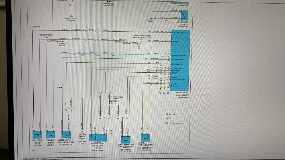

Former tech here, kinda baffled. Been out of the game 12 years so Can bus is new to me.
Here is how it happened, driving down the road and the oil change reminder popped up in the DIC so at the next stop I shut it off and reset the reminder. As soon as I started the car it coded and the gas gauge went to empty.
I have replaced both senders and pump(dumb) I have also ohmed wires 44 and 45 to wire 9 in the PCM connector with the battery unhooked. Readings with 5 gallons of gas then added three gallons and started the car. The pump transferred fuel so everything back there is working properly. I also unhooked the ground to the under hood fuse box.
The gas gauge when I clear the code will move up slightly for a few seconds and when it re codes it will go dead again. Buddy has a scan tool and the fuel gauge failed a gauge sweep test.
Has these codes in the system:
ECM P2067
TCICM U1804
EBCM C0242
SCM U 0073-00 ans U0100
All is back together, car drives and starts fine just has no gas gauge and the "miles to empty" is inop.

Reference InformationSchematic Reference
Instrument Cluster Schematics
Connector End View Reference
Component Connector End Views
