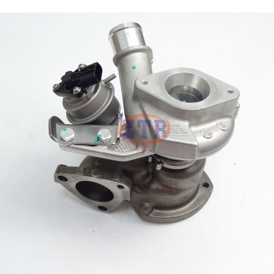

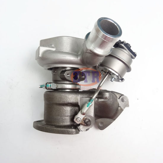

Attached photos of turbo for reference

I used Autel ultra for the learning I have gscane 2 also but I didn’t remember if it has the option, the attachment below is how it looks the turbo on my ford ranger 2.2 just takes the turbo pan it so easy to adjust if you have small fingers like mine thanks.
