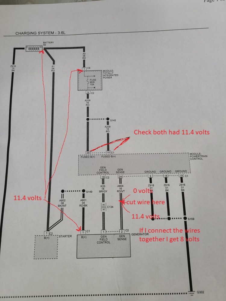

I found a diagram today and I guess I was checking the circuit wrong. I thought power came from the PCM to the alternator on the gen sense wire and came back through the gen field control. Kind of like a hall effect sensor. I have attached a picture of my voltage readings. The battery was low from running that is why in the picture I had less than 12 volts. And the voltages at the 2 fuse B+ on the PCM are with the key on and the others are with the van running.Thanks for the help

Tyler I checked the voltage like you asked. Also voltage is different from picture cause I charged the battery last night
B+ at the battery 12.4v
B+ at the alternator 12.4v
Pin 1 BR/GY at the alternator 0v plugged in.When it is unplugged 0.6 volts on wire and no volts on pin in alternator
Pin 2 RD/VT at the alternator 9v plugged in.When it is unplugged no volts on wire and 12.4 on pin in alternator
Alternator is grounded
Also I checked voltage at the PCM for the BR/GY with only the key on and I get 0.6 volts.
Ruh roh. :unsure: That's the field wire for the alternator. To be clear, the engine was running when you took that reading, right?
If so, then you have to ask if the lack of field control is intentional, or because the driver in the PCM is smoked. What kind of scan tool do you have available?

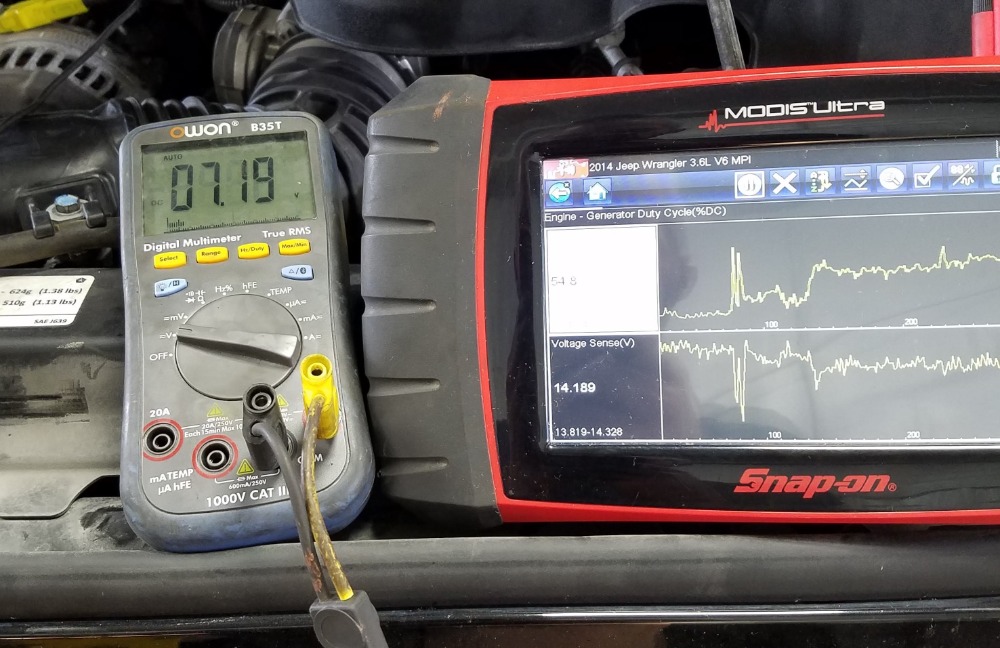

Correct. It's a high side driver (power side switched in ScannerDanner-ese) that controls field coil strength directly. More field current -> more alternator output. The PCM will never full field that circuit, only pulse width modulate it.
For perspective, I took this off a '14 Wrangler. Same engine, same charging system.
The meter is connected to the same alternator field wire. Scan data shows the duty cycle percentage. The Voltage Sense PID is NOT the sense wire at the alternator. ;) It's just reading fused B+. Chrysler/Dodge/Jeep likes to make things confusing. ;)
Your reading of 600mV suggests almost no current flow on that circuit. IMO, you're down to a PCM that is intentionally not fielding the alternator, or a PCM that can't field the alternator. I asked about your scanner because a bidirectional scanner could command the field driver on KOEO to check functionality. But that's OK, we can work around it.

Hardtopdr2 wrote: If he has a scope or know someone that does check signal sense with scope. I think he is getting an averaged reading if it is a pwm circuit. So it may be a higher voltage coming through the circuit.
I agree that he's looking at an averaged PWM signal. But given that 7.0V equals about a 50% duty cycle on a known good vehicle, and that he found 600mV on his, I think it's reasonable to assume that whatever duty cycle that is taking place (if any) is extremely short. Not nearly long enough to field the alternator.
600mV could be a 12V 5% PWM signal. Or it could be a low voltage higher duty signal because of an internal problem in the PCM. AC voltage and frequency readings might help tell what it is if all the OP has is a DMM. Really need a scan tool, and ideally a 'scope too, to diag this one conclusively though.
