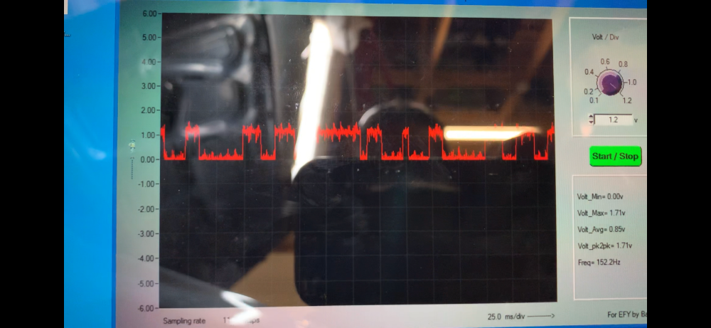

I made a simple oscilloscope with an Arduino and some PC software and I was able to see the CMPS signal with the car running and it looked like it was toggling between 'its' high and low of around an average of 1.2V high and 0 low. There was a LOT of noise on the signal but the system I am using was basically an antenna so whether or not the noise was a symptom of an underlying problem I really don't know. While I was in there I also measured the supply voltage and it was 5V and had some noise but nothing like the signal wire.

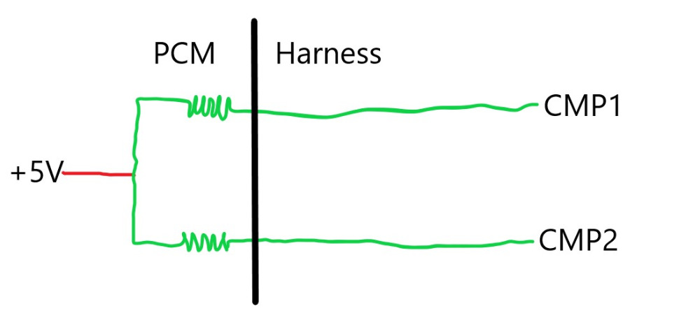

Each signal circuit should have its own current limiting, probably a resistor, inside the PCM. Should be able to ground one circuit without it affecting voltage on the other. So the fact they're both getting pulled down to 1.2V when either one of them is plugged in points to high resistance in the 5V supply feeding both circuits inside the PCM. Red portion of the crude diagram :silly:
One other test just to confirm would be unplugging both CMPs and hooking up a DMM across one of thems signal wire and sensor ground. Then short the other signal wire to sensor ground and see what it does to the other signal wires voltage.....

What do you guys think about the excessive noise on the 1.2V signal? Is that something that might narrow down the type of fault? I was able to take a snap shot from a video I took, see picture below.
Nah, that looks like typical noise to me. :( Like you said earlier, the scope leads will pick up all kinds of stuff underhood. I wouldn't sweat it.

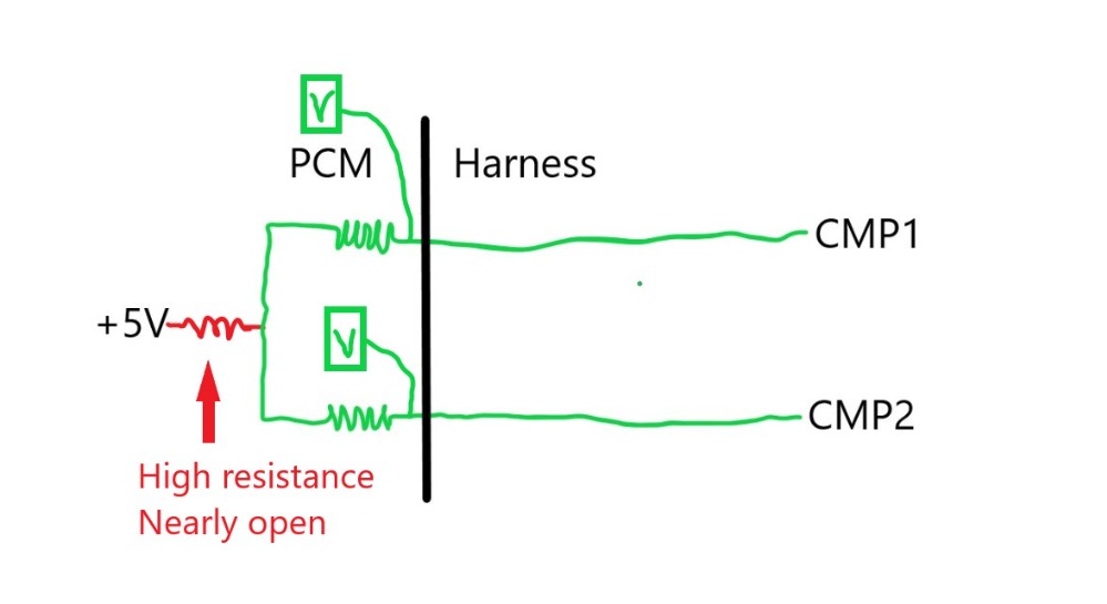

Borrowing the sketch Matt came up with earlier, I think this is what's actually happening inside your ECM:
With this failure, almost any load on either circuit will result in the signal bias getting pulled low.
Now that I'm thinking about it, are there any other sensors on your Kia that also have low 5V reference feeds? The MAP or the A/C pressure transducer would probably be the easiest two to check.

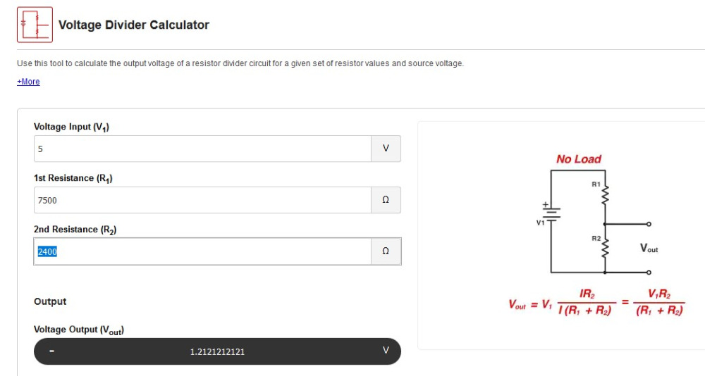

derekj308 wrote: I did measure the resistance of the signal to ground terminals of B1 and B2 to their respective ground terminals and both measured 2.4k ohms. I also measured the resistance of signal to power, B1 and B2 both O/C and same for power to ground both O/C. I know it sounds late in the game but shouldn't the CMPS signal be either short to ground or O/C, i.e., a switch :silly:, so the logic circuit in the PCM sees 0V or 5V respectively assuming the PCM has a pull down resistor? My understanding / assumption is the voltage measured in the PCM is after the pull down resistor. Any additional resistance in the signal circuit creates a split of the reference voltage and would therefore cause the PCM measured signal voltage to be either 5V or greater than 0V depending on the value of the pull down resistor and the 2.4k ohm resistor in series.
Electronic "switches" don't always go fully open circuit like mechanical switches do. They'll show some continuity with a DMM and also leak a small amount of current in their off state powered up.
2.4K does sound too low but that cold resistance doesn't necessarily mean that's what the sensor will do powered up. When you get everything back together you could try grounding the signal wires with some different resistors to see what they do to the signal voltage. I plugged 2.4K 1.2V into a calculator and it works out to 7.5K of resistance inside the PCM. But really need to re-do the measurement with a known resistance.
www.digikey.com/en/resources/conversion-...ator-voltage-divider

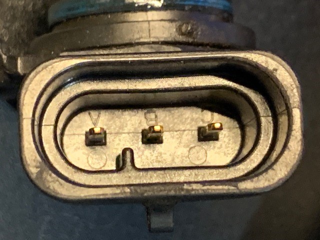

Forgot to mention the actual resistance values of what I measured on a good sensor.
C pin is 5V supply
B pin is signal ground
A pin is 5V reference signal
all pins are fed directly from the ECM
A to B 1.2M Ohms
B to A no reading any scale (no idea why this isn't the same as A to B, its a resistance, right?)
A to C 1.5M Ohms
C to A no reading any scale
B to C 1.2M Ohms
C to B 1.2M Ohms

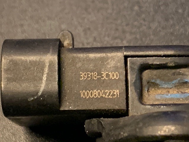

KIA Sensor P/N is 39318-3C100 and there is another number under it 10008042231, I am assuming it is a manufacturing tracing number.
