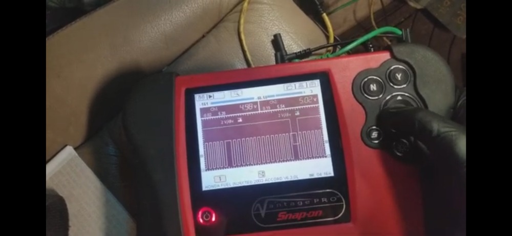

Sorry for getting back so late. I kept trying different things and I narrowed it down to the crank sensor. Its acting very strange. Watch the video and give me your best solution.

You need to plug the black lead into ckp ground (terminal 1) and yellow into ckp signal (terminal 2) this might be the problem with the scope reading. What is the green plugged into

I had the black lead on the engine ground and a test light on the sensor ground wire to test sensor ground integrity. Green lead on sensor supply (12v supply) and yellow on signal wire.
Cam sensor gives a normal square wave with those scope settings. I can take the sensor off and wave a screwdriver in front of it and it produces a square wave. But when it's on the car, it works a little bit and then does that.

If you have consistent spark and injector pulse, and RPM on the scan tool, I wouldn't invest any more time into the crank sensor.
Your first video shows a good signal, the second video is hard to see the scope screen while you are cranking the engine.
You could try a relative compression test (or in cylinder if you have the tools) with a sync on #1 ignition coil control to prove the coils are firing @ or near TDC compression to prove CKP signal and timing are correct and that the reluctor wheel on the crank shaft isn't misclocked (unlikely given the key way) or otherwise damaged.
