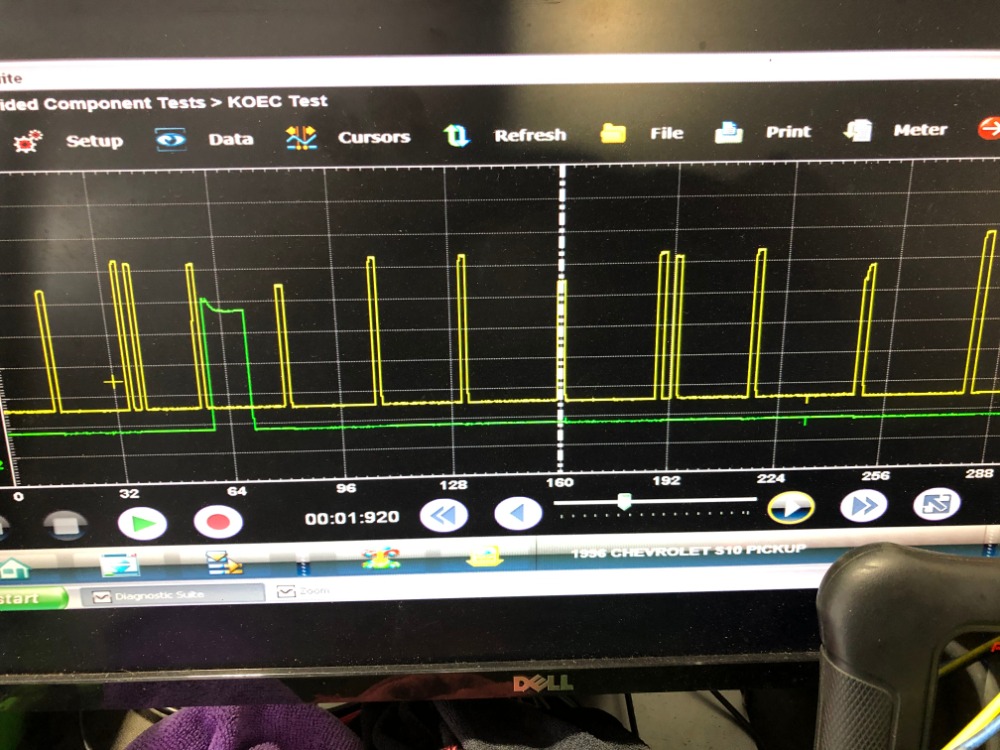

Got one in the shop today. Another shop did a timing chain and vehicle won't start. I'm suspecting they are off a few teeth. Does anyone have a known good cam/crank signal. This is what I'm seeing

Did it ever run after timing chain replacement?
