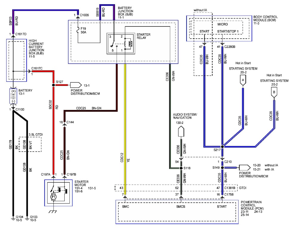

Starter relay reinstalled using a relay break out like this one:
Pin 1 of the control side of the starter relay is SMC (starter motor control) ground side switched. With the my meter connected to this pin, it is observed that ground is applied.
Pin 2 of the control side of the starter relay is SMC S (starter motor control something else, lol).

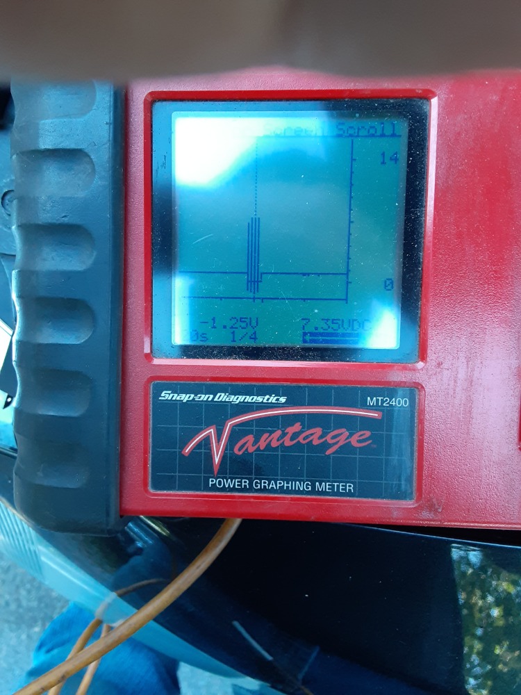

With my meter connected to that circuit I get this:
7ish volt spikes...
(The battery is low at this point, but even with a charger on the battery charging at 13v this voltage is never greater than 9v)
So this kind of explains why my test light would illuminate when placed across the starter relay control terminals, and is likely the reason that the starter relay is not being activated.
The same voltage is measured at the base of the under hood battery junction box, and directly at Pin #37 of the PCM.
So the irregular voltage is not the result of voltage drop on the SMC S circuit.

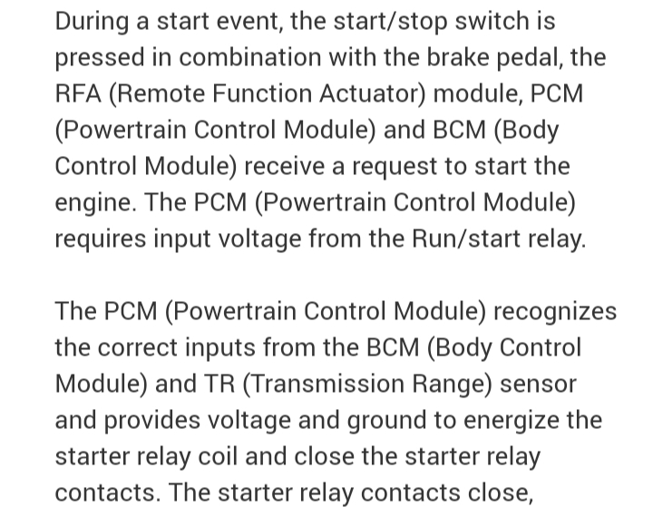

According to service information, the PCM requires voltage input from the Run/Crank relay to activate the starter motor relay:
My interpretation of this information is that the power from the Run/Crank relay is literally the power that the PCM is switching to the SMC S circuit of the starter relay.

At this point, since they're all on the same connector and since I have the PCM exposed, I decide to check powers and grounds at the PCM with my test light, including the Run/Crank voltage input.
All powers and grounds check out, and my test light lights with the starter button engaged on pin #16, the Run/Crank voltage input to the PCM.

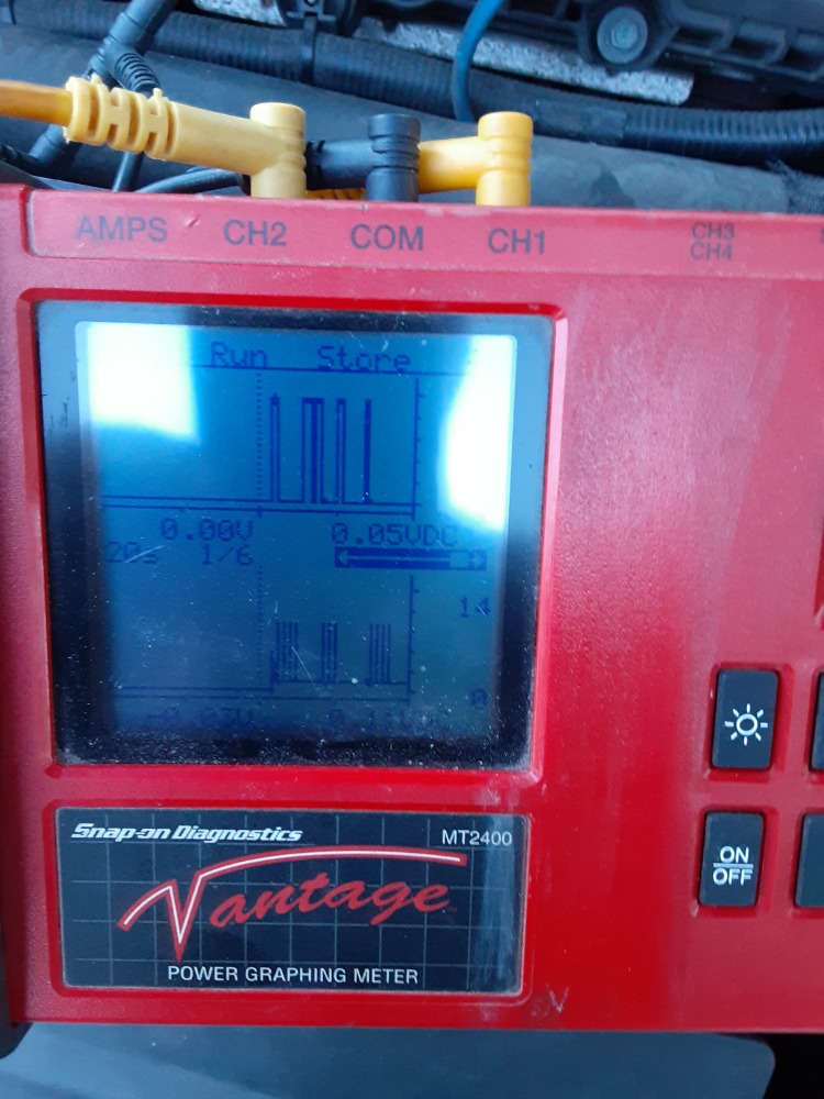

However, with my meter in place on pin #16 of the PCM (Run/Crank relay voltage input), as well as pin #37 of the PCM (SMC S starter relay power side control) I observe this:
:blink:
Battery (charger) voltage pulses into the PCM from the run crank relay and the same significantly lower voltage pulses on the starter relay control power side switched circuit!

Just because the PCM needs to see the Run/Crank relay doesn't mean it uses that feed to supply the Starter relay. So your power feed bypass test isn't conclusive. And you only tested the other PCM powers with a test light so there could be others pulsing too.

My hunch on this is leaning towards a melted wire pulling down your circuit.
Have you depinned #16 to see if voltage rises on ECM #16 pin?
I'm going by a '14 wiring diagram so check the '13 agrees with what I'm saying.
They could've worded that better. Pin # 16 is the "request to start" mentioned in the first sentence. It's drawn as an always hot fused feed from the BCM to the start switch then on to the modules. Simple circuit that shouldn't be pulsing.
"The PCM also requires input voltage from the Run/Crank relay" would be a better way to word the second sentence. It should be energized in both Run and Crank by the BCM.

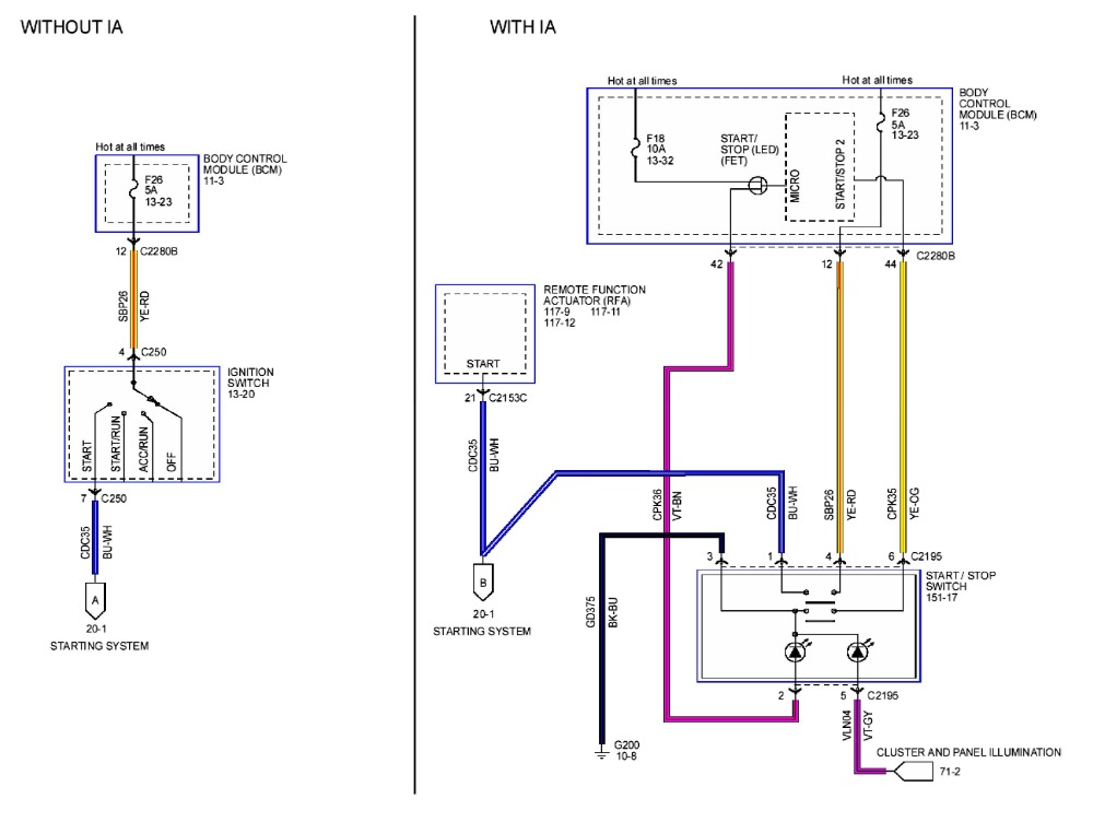

If I can get more time with the car at some point I want to scope fuse 25 at the bcm that is the hot at all times power feed to start stop switch.
I agree with you that it looks s though there should be no pulsing. If there's steady voltage in and irregular voltage out of the start stop switch, then I'll have to investigate the possibility of a faulty push button. So I'm either in a place where the test light has let me down, or the scope has over complicated the issue, lol.

I discovered that the voltage pulsing into the PCM while operating the start button was my helper trying to do Sub-Zero's finishing move....
With myself in the driver's seat and my Vantage at a 20 second time base, I had plenty of time to press the button and go under the hood to look at the meter. The voltage from the ignition button was indeed full system voltage for the entire duration of the button press. However the starter relay control voltage supplied by the PCM was still low, pulsed voltage.
