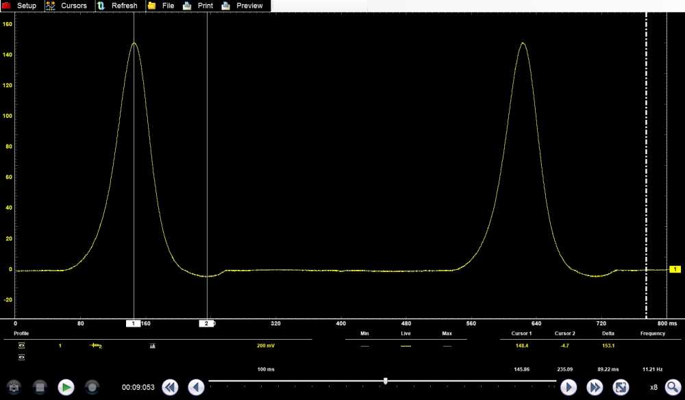

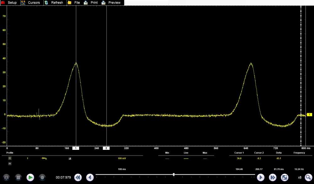

Looking for another second opinion on an in-cylinder capture! This one isn't quite as easy as the last one I posted . :lol:
2011 Ford Escape, much like the last case. Audible compression problem, obvious misfire, relative compression points to #2. Here's the running in-cylinder capture:
This cylinder has a leaking exhaust valve, confirmed with a leak down test. 95% leakage. My question to you is, was the leaking valve obvious in the in-cylinder capture? My understanding says that, if there's a leaking exhaust valve, that the decompression pocket vacuum level (cursor #1) will be weaker than the intake stroke vacuum level (cursor #2). But this one is exactly the opposite. :blink:
Welcoming all questions/comments! Please feel free to comment even if you don't feel comfy with in-cylinder captures. We're all here to learn from each other. :)

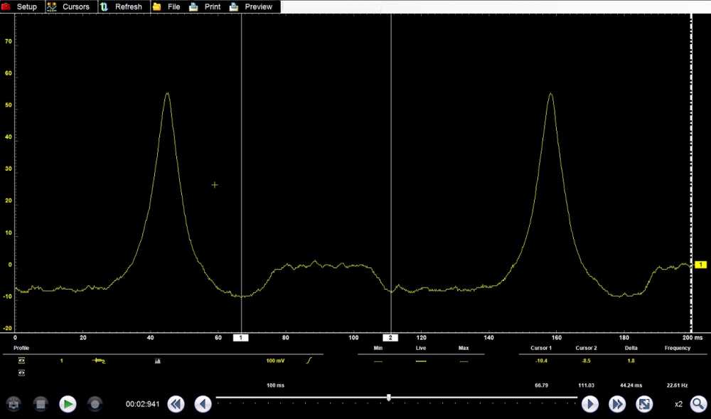

9 years 8 months ago #5632 by Andy.MacFadyen
Replied by Andy.MacFadyen on topic What'd I miss? In-cylinder capture

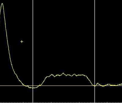

Tyler I added a horizontal ruler to your capture and cropped it down.
I also looked through any captures I had and found nothing similar.
9 years 8 months ago #5634 by SniperDan
Replied by SniperDan on topic What'd I miss? In-cylinder capture
I think I have an answer, though it could be completely off base. On the power stroke, both valves would normally be closed, but with an exhaust valve that is leaking it would behave similarly to an intake stroke, pulling a vaccuum from air in the exhaust pipe. It could do this because the intake valve would be sealed. Now on the intake stroke, we have less vaccuum being achieved because BOTH valves are technically open given the leaking exhaust valve. Does that make sense/ sound feasible?
~W. Edwards Deming
9 years 8 months ago - 9 years 8 months ago #5660 by Andy.MacFadyen
I think got my head round this last night and went over it in my head a couple of times this morning, so here is my theory.
First consider an in-cylinder test on a healthy cylinder. The cylinder is filled durring the induction stroke by air at inlet manifold pressure (ie partial vacuum), and durring the compression stroke it is compressed to 80 psi or so above atmospheric pressure. As the valves are sealing effectively the mass/weight of air trapped in the cylinder reamains unchanged.
On the expansion stroke the piston the air trapped in cylinder expands back to very close to the original volume and pressure.
On engine with a leaking exhaust valve more air will leak out durring the compression stroke than in will be drawn back into the cylnder via the exhast valve leak durring the expansion stroke. The mass/weight of air trapped in the cylinder will be less than if valves sealed perefectly so unless the exhaust valve leak is huge the pressure at the end of the expansion stroke must be lower than end of the exhaust stroke.
Camshaft timing, dwell and overlap will also effect the depth of the pressure pocket.
It would be interesting to have an in-cylinder cranking compression test on this engine as I would expect the compression-expansion towers to not be symetrical and show a noticeable lean to the right.

9 years 8 months ago #5675 by Tyler
Replied by Tyler on topic What'd I miss? In-cylinder capture
Andy.MacFadyen wrote: On engine with a leaking exhaust valve more air will leak out durring the compression stroke than in will be drawn back into the cylnder via the exhast valve leak durring the expansion stroke. The mass/weight of air trapped in the cylinder will be less than if valves sealed perefectly so unless the exhaust valve leak is huge the pressure at the end of the expansion stroke must be lower than end of the exhaust stroke.
This is what I was thinking, sir, but your explanation makes way more sense. :)
My rough math equates 1 PSI of pressure to 2 inHg of vacuum, so the reading of -10.4 PSI at the end of the decompression stroke equates to over 20" inHg. That tends to say good sealing, right? But I know this isn't the case. :unsure:
*sigh* I actually did a cranking capture, but forgot to save the waveform. :blush: I was looking for a leaning compression tower, too, but didn't see one... It *was* Friday at 4:30 PM, so maybe I wasn't looking as carefully as I should have. :lol:
On Monday, I'll grab a running capture of a known good cylinder, as well as cranking captures on #2 AND a known good.

  • Tyler's Avatar Topic Author
9 years 8 months ago #5761 by Tyler

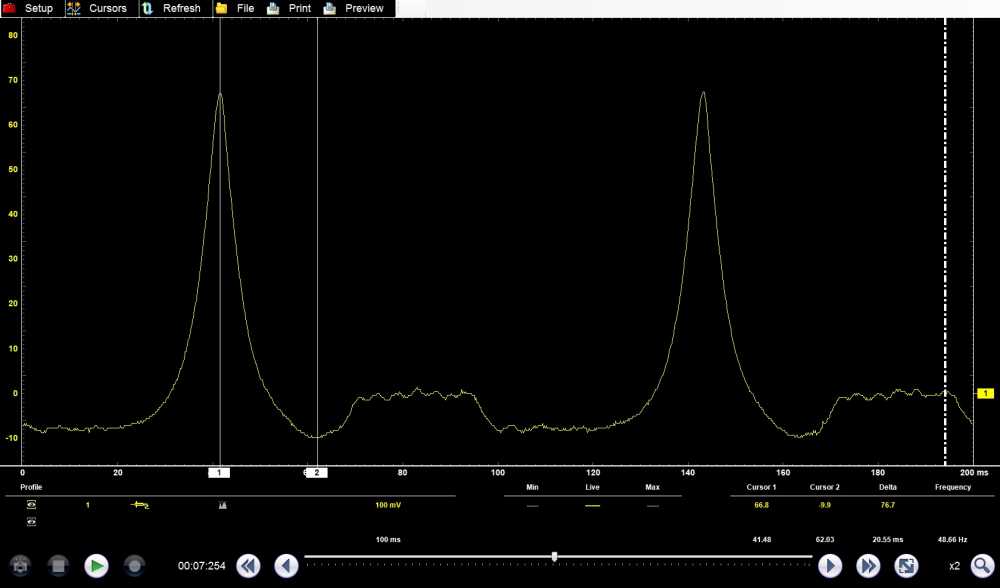

Back with some more captures! Let's see if y'all can make sense of this stuff. :blink:
So Andy pointed out that a cranking capture would be more likely to reveal a leaking cylinder, evidenced by a 'leaning', asymmetric compression tower. He's absolutely right, so I went and grabbed cranking captures on the bad #2 cylinder, and a known good #1 for reference.
FYI, keep an eye out on the scaling. All the readings on #1 exceeded the 100mV scale on my Modis, so I had to change between cylinders. The conversion is 1mV/1 PSI.
#1 (good) cranking:
#2 (bad) cranking:
And there it is! Nothing symmetric about that #2 compression tower... The low peak compression matches what I saw on the relative compression.

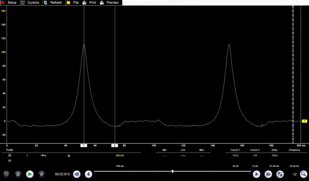

Here's where it gets weird. I retook the running capture on #2, and #1 for reference.
#1 (good) running:
#2 (bad) running:
Something I hadn't noticed before - the running compression is higher than the static compression on #2. How does that work? :blink: :lol:
My (very rough) explanation: Because the engine speed is lower during cranking, the leaking exhaust valve essentially has more time under compression to leak. Once the engine is running, the cylinder events happen much faster, and the leaking valve has less time under compression. Does this make sense, or is this BS? :lol: I really don't have a solid answer here. Please feel free to comment!
9 years 8 months ago #5782 by Andy.MacFadyen
9 years 8 months ago - 9 years 8 months ago #5786 by Andy.MacFadyen
I think you have nailed it -- longer time under compression more air leaks out.
Thinking about it if you try to push air or any gas too fast through a very narrow gap because the air flow speed increases and goes supersonic. Supersonic shock waves form which "choke" the gap increasing the ressistance to flow which slows the air down.
Last edit: 9 years 8 months ago by Andy.MacFadyen.
9 years 8 months ago #5857 by Tyler
Andy.MacFadyen wrote: I think you have nailed it -- longer time under compression more air leaks out.
Sweet! It's always cool when there's a scientific explanation for something you know intuitively. B)
So the head is coming off this one. I'll be sure to update when I get a look at the valves.
9 years 3 months ago - 9 years 3 months ago #10860 by Tyler
Update outta nowhere! So, I totally forgot to get pictures of this one, but it did end up having a burned exhaust valve. ;-) Nice chunk missing from the edge.
I knew I'd find an exhaust valve problem because of the leak down test. What really blew me away was how much compression this thing was still generating despite the leak. :ohmy: I went back over the captures, and I still don't think the answer was very forthcoming. The leaking cylinder was still able to draw 16" inHg during cranking, and showed 18" on decompression when running. Very confusing. :angry:
Honestly, I think this is when a FirstLook sensor or similar would have been valuable. Couple the FLS in the exhaust with an ignition sync, use an overlay, and I'd have my answer. Either I need more experience with the in-cylinder transducer, or in-cylinder wasn't the tool for the job.
