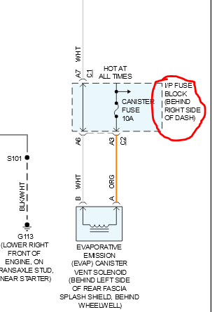

Hey, everyone! I'm finally caving in and asking for help. I've done hours upon hours of research on this issue and can't seem to find what I'm looking for. I had this code come on and immediately just thought I'd replace the solenoid. When I went to put the new solenoid on, I realized the wires were cut about 6" from the vent solenoid. So, I put the new one on and fixed the wires with heat shrink butt connectors. I immediately threw the same code again.
At that point a light bulb kind of went off in my head and I realized that I definitely have a wiring issue as the code throws almost immediately. So I started to trace the wire from the harness at the vent solenoid. I noticed as it went through the body plug to the inside of the trunk the wires were broke there as well. So, I fixed those as well, yet again with no luck. I then decided I was just going to cut the wires inside the trunk so I could eventually just wire them straight to the new plug that I had to get for the new vent solenoid. I figured that would reduce the number of connections and limit future issues.
I then used my multi-meter to test the wires for power and discovered that the white wire was reading around 380 MV and the orange wire was receiving no reading at all. In full disclosure, I'm not a mechanic, or any type of super experienced guy with electrical diagnostics. I do however love to learn how to do things as my 5 year old boy is always with me and I want him to learn right along with me. I'm just at a point where I don't know what I should do next. I can't find where there's a fuse for this anywhere, or any type of wiring diagram for that matter.
My thought was, if I could find where the wire originates from, I could start trying to trace it towards the back and see if I can find a fault in it somewhere. I haven't traced the wire from the back any further than the front of the trunk where it disappears again. As far as diagnostic equipment is concerned, I've just got a one way OBD-II reader and a multi-meter. A good friend of mine has a Snap-On diagnostic tool, but he is gone on vacation. So, I"m just looking for some ideas on where to turn to next.
This code doesn't affect the ability to drive the vehicle in any way, it's more of just a challenge to myself at this point. I really appreciate any advice that anyone may have, and I hope I've explained things well enough so you understand where I'm standing at the moment. Thanks in advance!

thisdj1 wrote: I then used my multi-meter to test the wires for power and discovered that the white wire was reading around 380 MV and the orange wire was receiving no reading at all.
Excellent! The WHITE wire is the control wire. The 180mV, that you are seeing on it, is likely a bias voltage. Seeing this indicates that the control wire is good. It is this bias that the computer uses to detect problems. When the circuit is complete/intact. The 180mv will be raised to battery voltage, do to the constant power that is SUPPOSED to come in on the ORANGE wire, and through the solenoid winding. The computer KNOWS there is a problem because it does not see the voltage as battery voltage. Check the Canister Fuse (behind Right side of dash).

You've given me some hope here! However, looking at the fuse block diagram, I don't see a canister fuse for a 2005 Grand Prix.
5 years 11 months ago #43347 by Matt T
Replied by Matt T on topic P0449 2005 Grand Prix GT
Code description mentions a fuse. Probably the one labelled "CANISTER" in the Instrument Panel Fuse Box.

5 years 11 months ago #43348 by Chad
Replied by Chad on topic P0449 2005 Grand Prix GT
thisdj1 wrote: You've given me some hope here! However, looking at the fuse block diagram, I don't see a canister fuse for a 2005 Grand Prix.
Make sure you are looking in the correct Fuse Block. There is more than one. Are you looking under/behind the right end of the dash, in the passenger compartment?

There's 12 fuses in that panel, labeled A through L. But nothing that says anything about a canister or anything related to EVAP. I checked the diagram for the one under the hood as well and it too doesn't say anything about a similar fuse.

Well, I guess, start by checking all the 10 amp fuses. I'll see if I can come up with more helpful guidance.

I may owe you an apology. I'm not back to the vehicle yet so I haven't confirmed it with my own eyes! I did an online search and didn't see a fuse for it. However, Matt T posted a link to my owners manual and it does appear that there is a canister fuse. I'm on my way there and I will confirm it one way or the other. Again, sorry for any misinformation.

Alright. I made it back and checked the fuse. Sure enough, it's fried. I'm going to try to round up a replacement and get back on it. Fingers crossed!

Alright, I owe an apology to the forum. I found the fuse, it was blown, I replaced it and had 12v at the orange wire at the solenoid. I tried to exhaust all resources before coming here and wasting anyone's time, only to do just that. I really appreciate the help from everyone though. Now, I'm going to make another post for the last code that keeps messing with me. Thanks again everyone!
