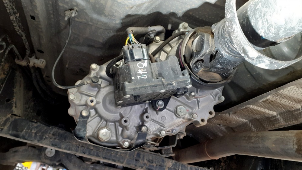

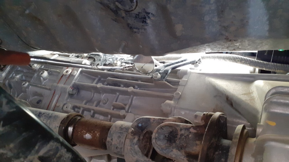

I have a feeling it's the 3 wire sensor behind my mirror in this picture, I'll scope it.
The transfer case threw me out because it adds so much length to the back of the transmission, I thought that
area was too far forward to to have a vss.

Nope, that was just the neutral switch that responded each time I changed gear.

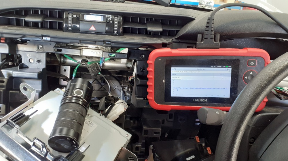

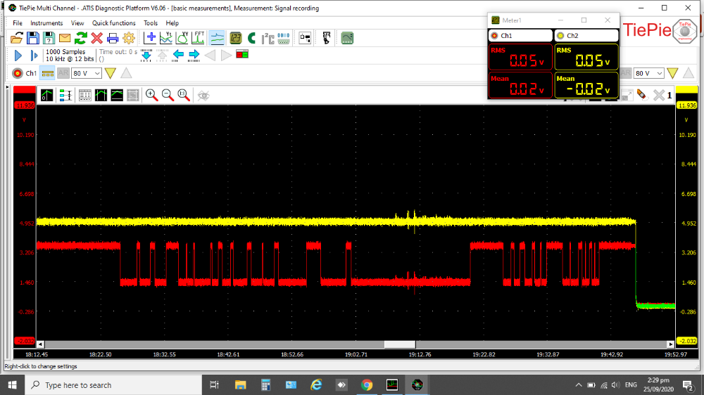

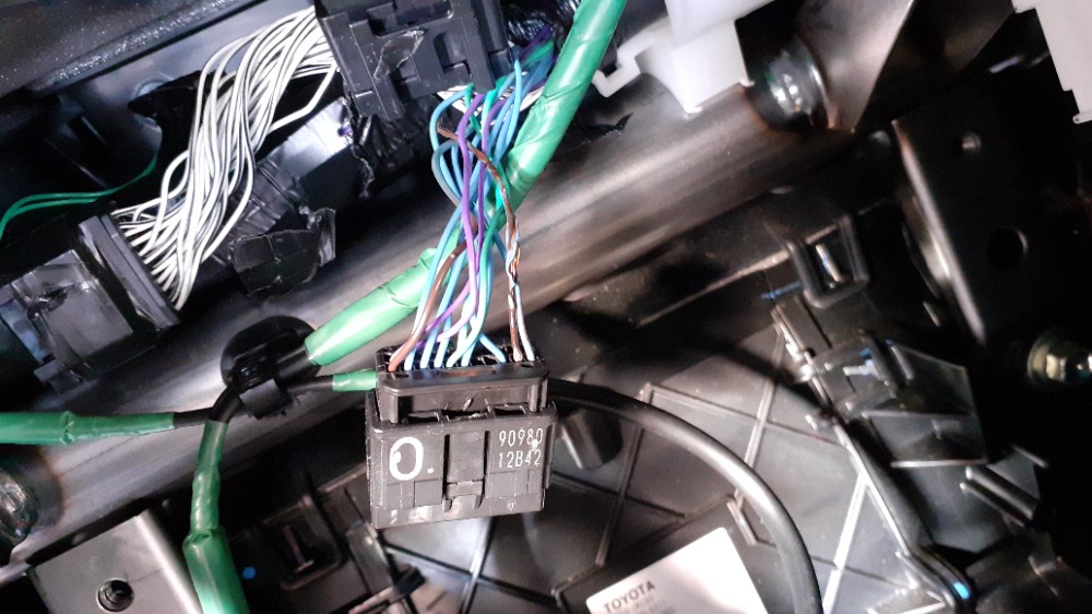

Finally found it with some guidance from the www.tat.net.au/member-area.htmlTAT forum . The instrument cluster sends out a vehicle speed signal to
all the other modules. Behind the radio is a black connector wit all the speed signals splitting up. Most likely due to
the worker [won't refer to them as a technician] who bolted the tail light feed to ground, then swapped fuses around,
there is a burnt wire in the harness which was melted to the VSS signal wire. After moving that wire we now have vehicle speed
in live data. [note: the Launch CRP123X is a brilliant little scan tool]
