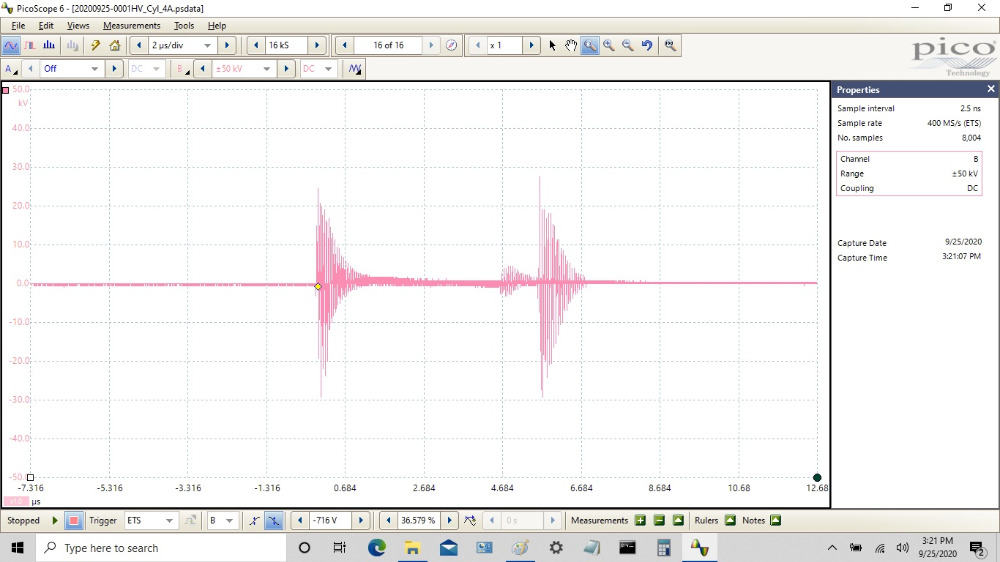

What are these Ign.scope views are telling? was created by Batiscafo

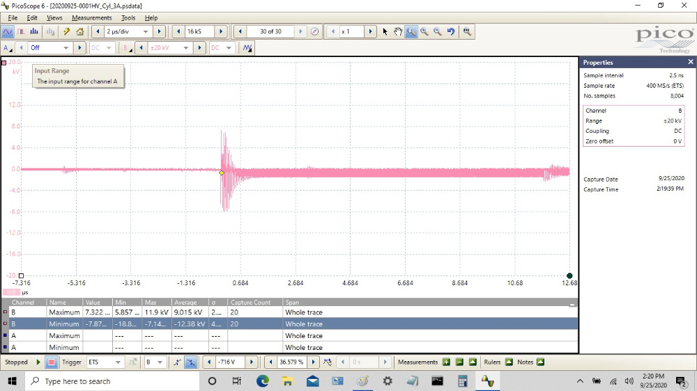

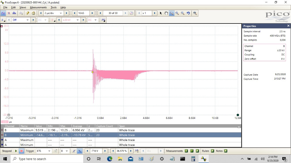

4Runner 1995 A/T 2X 3VZ-E engine
engine does not run well a any speed
Fuel pressure 39 psi with regulator, 39 with it on.
New plugs, wires, distributor, coil, igniter, injectors
Idles bad at 850 rpm, real missing a lot somewhere between 2000 and 1400 rpm
runs better at approx 3000 rpm
Starts easier if cold. after a long warmup, slows its rpm and misses even more until it quit with some kind of backfiring (gentle)
Makes no difference at any time of the paper clip is on or off on the Engine Connector
Exhaust recirc valve vacuum disconnected now, and inspected a few weeks ago and did seems to move up and down closing well with easy.
Timing belt checked recently
Knock sensor new mounted temporarily on one of the engine lifting ears.
What do these HV Ignition are telling, I have no clue.?????
The scope used was: Pico 2205A with HT-25 probe right at each cylinder HV wire. Engine on fast idle, approx 900rpm Chanel B
For some of the cylinders I had to change the voltage setting because it needed just a touch higher.
Thanks

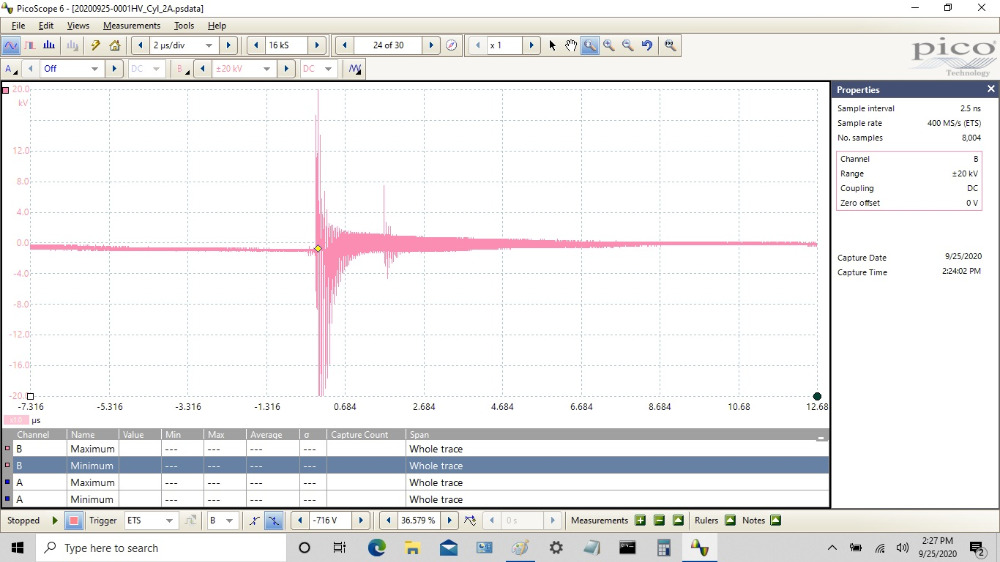

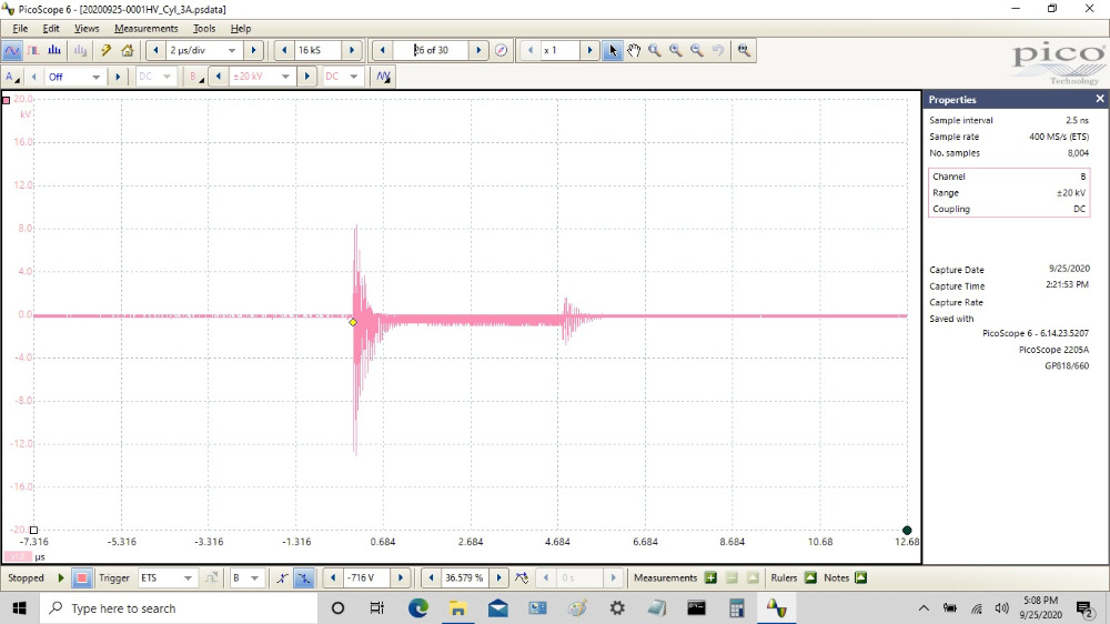

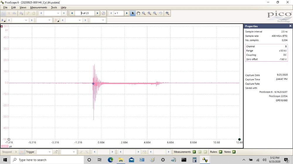

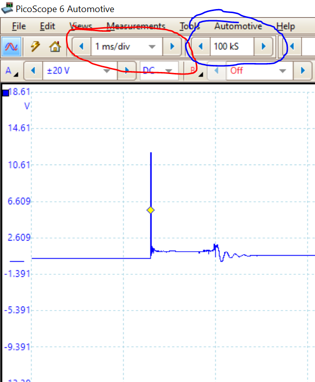

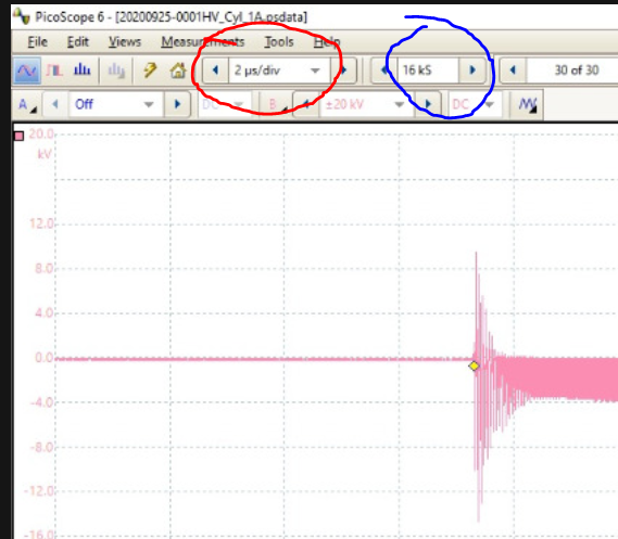

Your time base is WAY too fast. You are set on a time scale of 2µs/Div. (Circled in RED). Try slowing it down to 1ms/Div. Also, increase your sample rate (Circled in BLUE).

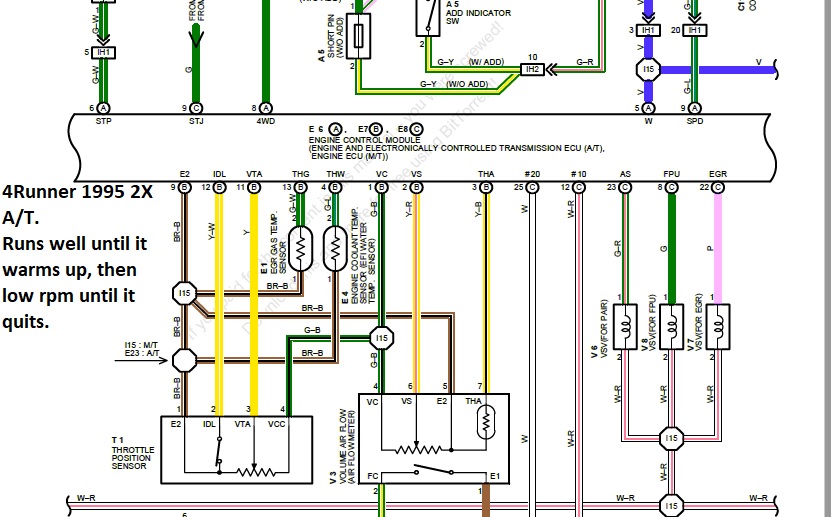

Just posed for a while and looking at the attached schematic that I think that maybe a good strategy would be to check the performance of the:
air temperature sensor
EGR tempt.sensor
engine coolant temp sensor
Since the engine runs very well on cool idle but quits when hot
The only strategy I can think for that would be just take the scope hooked at at the ECM from cold to hot (have only two channels and one 20X att enuator.
Any other ideas?
EGR tempt.sensor
Any other ideas?
