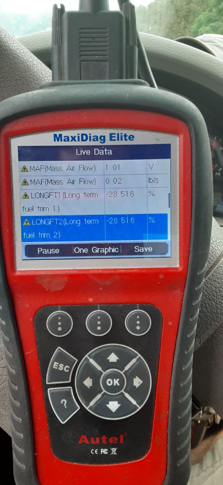

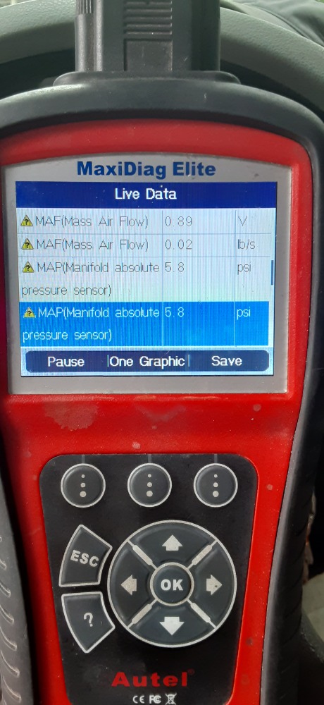

Ok here are some captures with engine warmed up at idle (650rpm)
Last edit: 5 years 11 months ago by Patrickreaves.

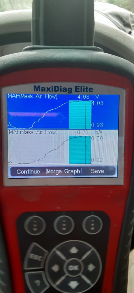

5 years 11 months ago - 5 years 11 months ago #43474 by Patrickreaves
This is a 1st gear pull to 4,700 rpm.

Monde wrote: The MAF specs with key on, engine running is 0.46- 2.44v. Your MAF voltage is within specs. It seems to be reporting accurately. Something else is causing the rich condition. Can you find the maf voltage specifications to compare it with mine? I got mine from mitchell.
The '05 MAF appears to be working properly but the '06 PCM isn't interpreting it correctly. VEs over 100 means the PCM is seeing more airflow than the engine can physically pump.
The following user(s) said Thank You: Monde, Patrickreaves

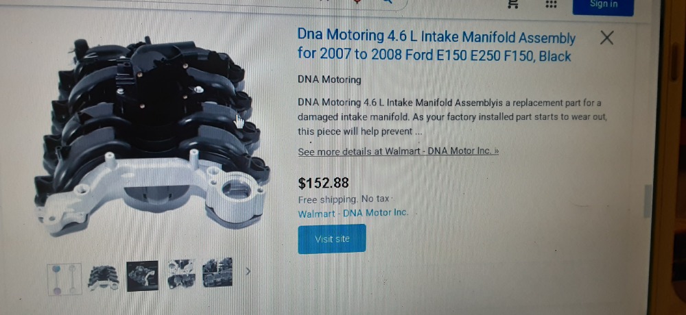

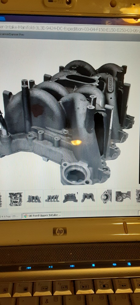

Here's the different manifolds. The little black plastic one is for the 07-08 f150 4.6
And the aluminum one is the one I currently have on my 2005( manufactured in 2004) f150 4.6.
As suggested above maybe there is a difference in the transfer function table in the micro processor between the two different engine computers, and thus causing the issue of the over reporting MAF sensor.
but at the same time, i am in mustang and f150 groups on face book , and there are a lot of people opting to swap out there intake manifolds with that of a ford windstar as it supposedly has the best intake. i wonder if they had issues like this. what about people that put the P.I. heads on non P.I. engines, surely doing any changes would cause air flow velocity issues.
I watch a lot of "ford tech makuloco channel" as he is a ford tech works on these fords and provides lots of content like scanner danner does. But he says that the maf spec should be .75 volts at idle and up to 4 volts WOT. but have not confirmed this spec with any other source.
