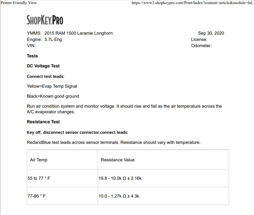

I have a 2015 Ram 1500 with a complaint of no A/C. The customer says that he has, recently, had the Radio/Climate Control head unit replaced, an the A/C has not worked since. All button pushes are registered, and I can command the compressor "ON" with a scan tool. I have concluded that the pid for Evap Core Temp is the problem. The pid reads a temp of 20°, 3 volts (at ambient temperature). I checked the resistance of the sensor and it is in spec. @ 3.1K Ω. I am seeing a resistance specification range of 1.2K Ω - 20K Ω, in [strike]Alldata[/strike] ShopkeyPro. I can use a 100 Ω resistor (WAY lower than spec), in place of the sensor, and pull the voltage down to around 2.2 volts, with a temperature pid reading of 38°. This kicks the compressor on.

Where did you find the spec of 1.2K - 20K ohms for the evap temp sensor? I've been up and down SI, and can't find a range. All the diagnostics have you ohm wires, then replace the sensor if it's all good.

Tyler wrote: Where did you find the spec of 1.2K - 20K ohms for the evap temp sensor? I've been up and down SI, and can't find a range.
I found it on ShopkeyPro. Not, Alldata. (I have Alldata, ShopkeyPro, and Identifix...$450/month in SI :woohoo: )

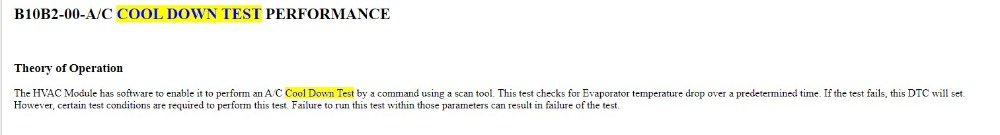

On-topic-ish? Did you know there's a scan tool function to check A/C performance on these? A/C Cool Down Test. Kinda like the Toyota flow test?
I haven't seen enough of these to know if the cool down test is worth a damn or not. :silly:

Tyler wrote: On-topic-ish? Did you know there's a scan tool function to check A/C performance on these? A/C Cool Down Test. Kinda like the Toyota flow test?
I did not know that. The Verus has many bidirectional tests but, I didn't see a performance test. I wonder if it can be activated without a scantool, by a button push sequence.
