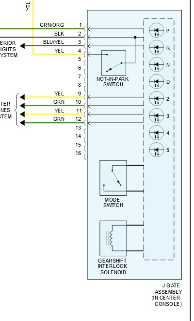

2003 jaguar s-type 4.2 p0706 range sensor code
5 years 11 months ago #43542 by wedo
can someone tellme where the range sensor is located,
is it inside the transmission or next to the shifter???
5 years 11 months ago #43544 by Chad
In the J Gate assembly. In the center console, According to Alldata.
5 years 11 months ago #43596 by wedo
oh ok, and is that same as the range sensor or the neutral safety switch???
