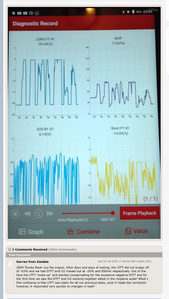

1az-fe Toyota Speed Density Engine
-24% STFT at idle
0% STFT after WOT snap and then back to -24%
high idle (1100 rpm, 900 when hot)
Car starts fine and road tests ok (a little sluggish on acceleration). STFT reduces to zero at various rpms during driving.

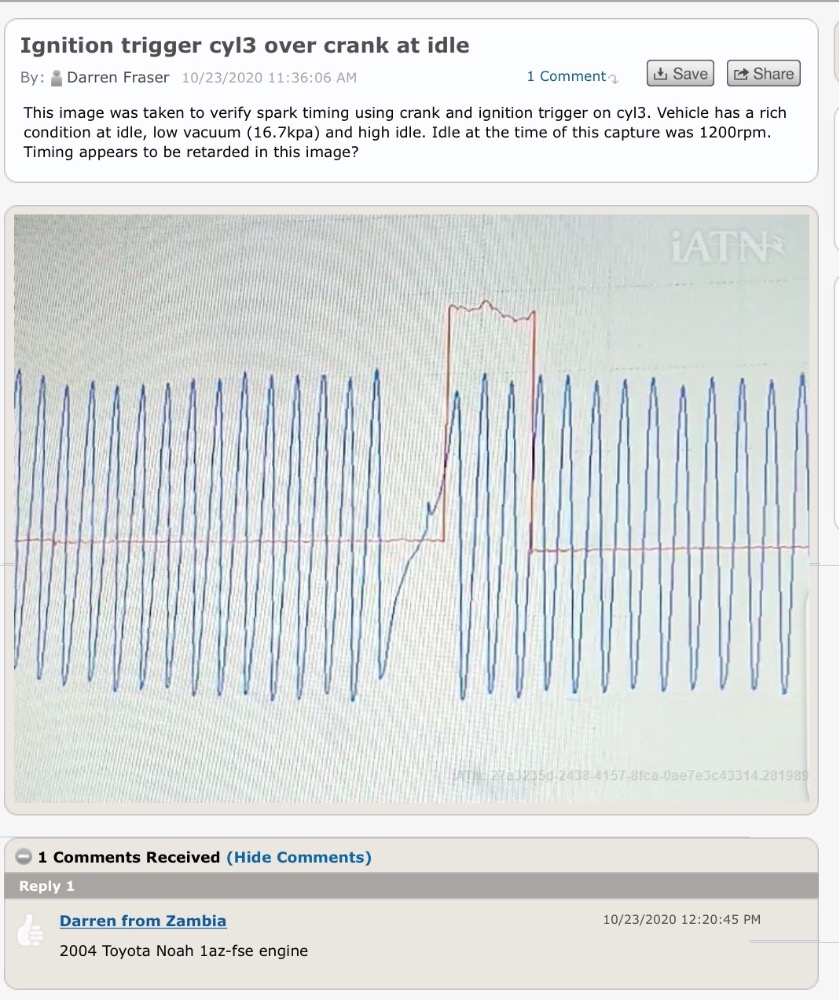

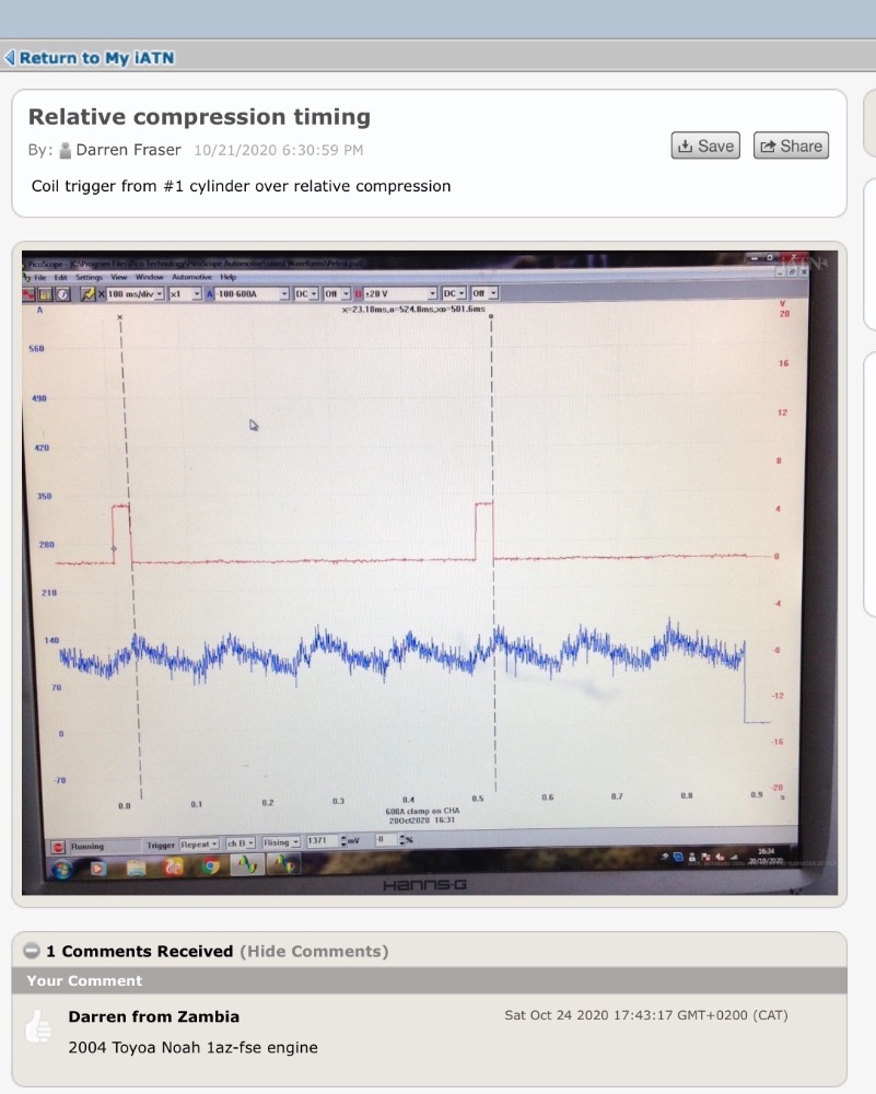

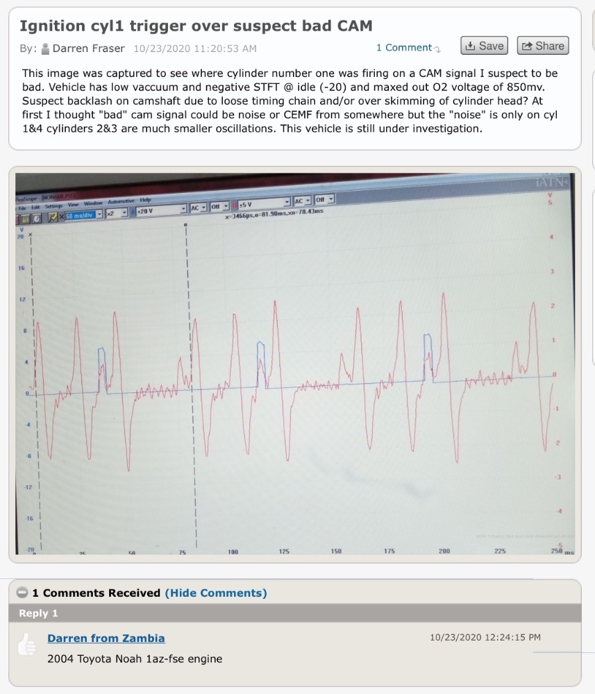

Thanks guys. I've been quite busy with this one on Iatn, there are a lot of very interesting feedback in there concerning this engine.
I'm looking now at the possibility of backlash on the camshaft based on the waveform I captured on the CAM sensor (Cylinder head over skimmed and/or stretched timing chain). I also think my timing is a bit retarded as well.
members.iatn.net/forums/search/search.as...orum2&ft=1&fv=4&qv=1
I'm going to try and post the wave forms in jpeg in this post, hope it works!
