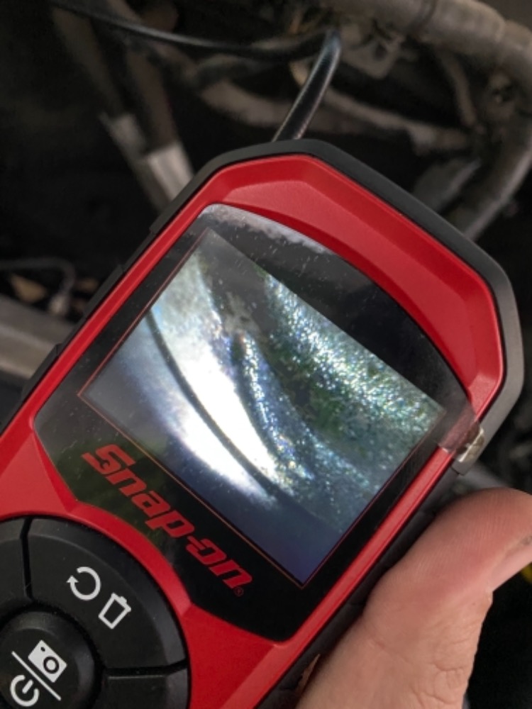

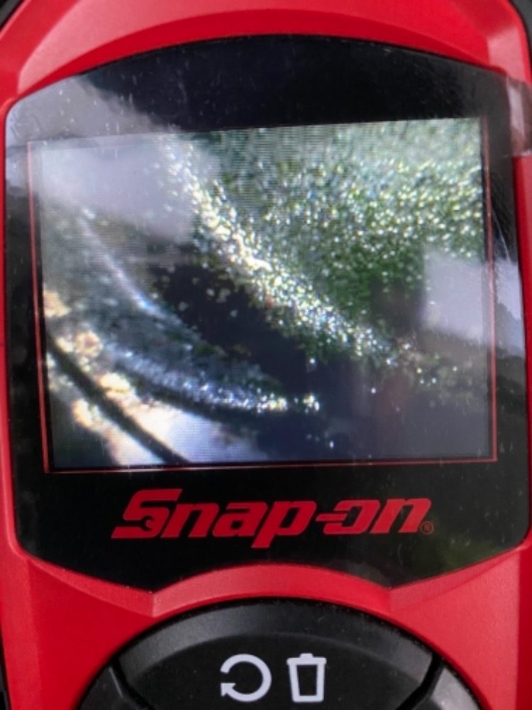

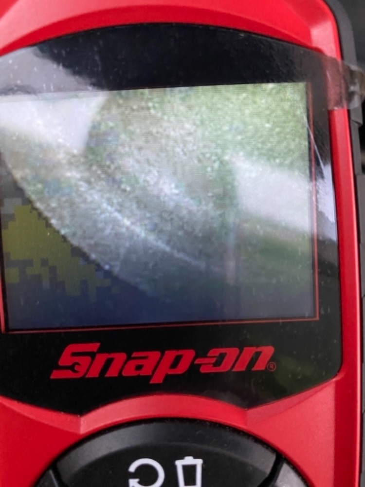

6 years 2 weeks ago #43924 by FordGuy1990
Replied by FordGuy1990 on topic P0301 Ford Escape
Here’s what the piston looks like, not sure if that’s the valve or a part made into the piston? Any ideas, the piston is clean expect where those to pieces are
