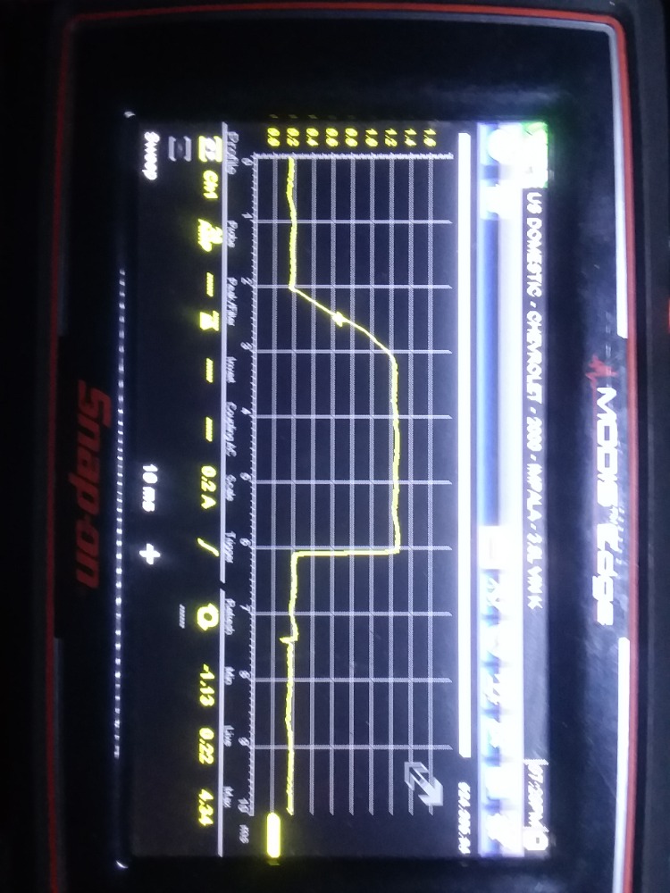

Ok im working on a 03 Pontiac grand prix with a 3.8l out of a 2000ish impala. I was checking current waveforms with my amp clamp and my modis edge. Heres where it gets weird. .... i set scope up for the amp clamp, scale, trigger and time base etc. So i scope the number three cylinder and a normal current waveform apears. So i move to the next one cyl 4 and the waveform is now showing in the negative amps (not inverted either) the base line would be at -1 and rise to 0 or 0.2 for the plateau). Checked the next cylinder #6 and different still. Keep in mind i did not change settings on scope and waveform was not inverted. I do t know what to think if my amp clamp is fudged or something else going on. Will post pics and vsm file when i can.
Not sure if anyone ran into this before?

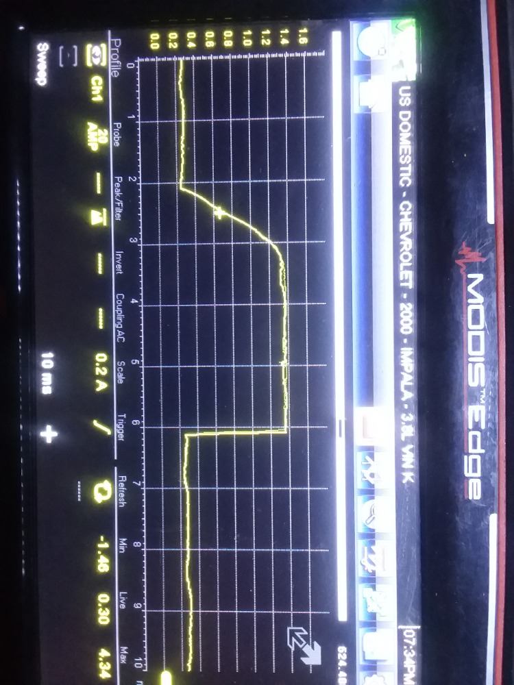

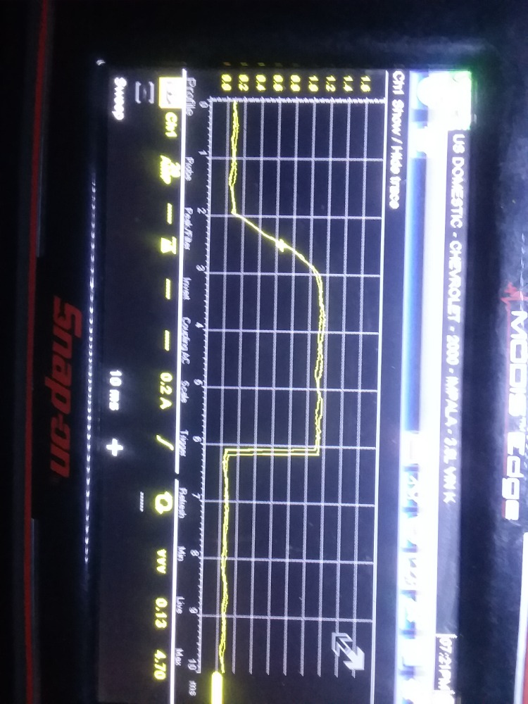

Here are the cylinders 1, 3 and 5 from my car. Apparantly if the amp clamp moves or is rotated the waveform moves up and down the scale. Which i dont think should happen. With the other car i would be holding it and it would be way negative on the scale or would be positive in the scale. As soon as i get to the car again i will get the waveforms again

When you put the clamp around the wire and leave it there with the engine off will it zero out correctly?
Why do the first and third picture show multiple traces?

The cameras capture rate might be catching two images while its taking the pic since scope has a faster refresh rate. With engine off it zeros out to zero no problems.

I've never seen a clamp that wasn't affected by wire position within the hole and clamp orientation. The amount of variation yours is showing looks about normal for a large clamp but I'd consider it excessive for a low amp one.
One thing that will mess with clamps is the jaws not properly closing. I always wipe off the jaw mating faces before I zero them.

This is just off if my car the one car i am having issues with was reading way negative after zeroing (-20 to -30 range) then another one was a base line of 12 and going to 18. Which i need to get the snapshots from the problem car again.

Update: the issue was interference from the alternator. when i repositioned the current clamp the readings matched up better. Just frustrating when this happens cause your just not sure.
