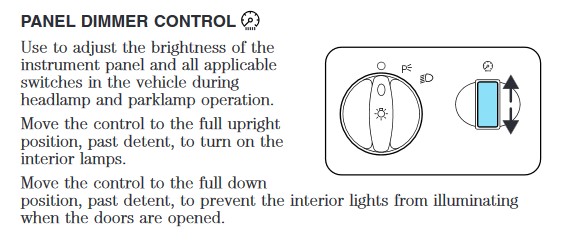

I use the dimmer switch and the light will stay on when keys are removed even when set to the lowest dimmer position. Also doors will not auto lock when driving over 5 mph and vehicle won't go into programming mode for key fob or auto lock.

All seems to point to the truck thinking a door is open. Have you looked for door switch PIDs yet?
