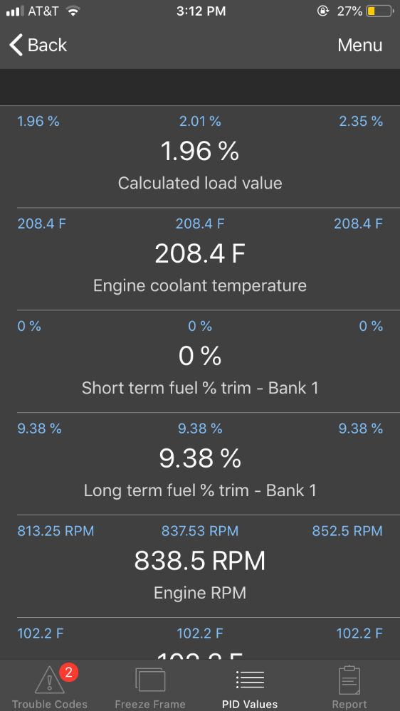

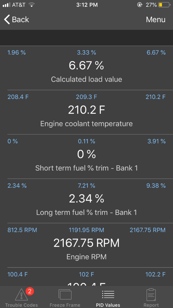

As title states I have a 1998 Oldsmobile 88 with the N/A 3800 engine.
The issue I am having is I have a very slight stumble at idle. No codes, and I am ruling out the IAC due to it being fairly new and the pintle responds well with KOEO and retracts just the same. I notice that at idle my LTFT is sometimes as high as 13% at idle with closed loop just starting, but after driving around a while it evens out at around 6-8% at idle. My STFT numbers are always hovering 0% so no problem there.
At idle when I snap the throttle or slightly depress it, I see the LTFT numbers drop. I know this is a classic vacuum leak issue, but I'm not sure that is the only contributor to my issue. I have smoke tested the intake many times. I've fixed all the vacuum leaks, except I discovered I have a leak in the crankcase. On this engine, the side of the block that bolts to the transmission has a cover similar to a timing chain cover. I suspect the gasket on that cover has gone bad because I get smoke in the bell housing of the transmission/engine block. I know this theoretically will contribute to a lean condition due to the PCV system getting unmetered air, but I'm not sure how much this would contribute to my issue since the PCV valve is a fixed vacuum leak. I do acknowledge the leaky gasket is a problem, but as it is I cannot repair this. I did a ton of work to this car and just got it aligned after front end suspension rebuild, and did a lot of internal transmission repairs. Separating the engine from the trans to repair that gasket is just not something I plan to do as of right now.

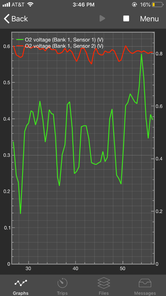

I can live with the LTFT as it is and accept that the repair is too great for me to want to deal with at hte moment, but I am wondering if my stumble at idle may be a separate issue. I've tested o2 sensors and there is no fixed rich or lean condition, and the sensors respond appropriately to a propane test.
I wanted to get a second opinion on my MAF data though. At longer sample rates, it seems my square wave is not consistent, and the stumbles are consistent with the longer PWM pulses I see on the scope. Due to my scope being a cheaper chinese scope and not specific to automotive testing, I cannot graph frequency, but I still feel like the MAF may be bad based on the scope data. When I say the car stumbles at idle, I am talking very slightly. It idles at a fixed rpm +/- 100 or so, and it drives fine. But the stumble is there, and the drop outs in the MAF signal correspond to the stumble as stated.
Any help is greatly appreciated.
