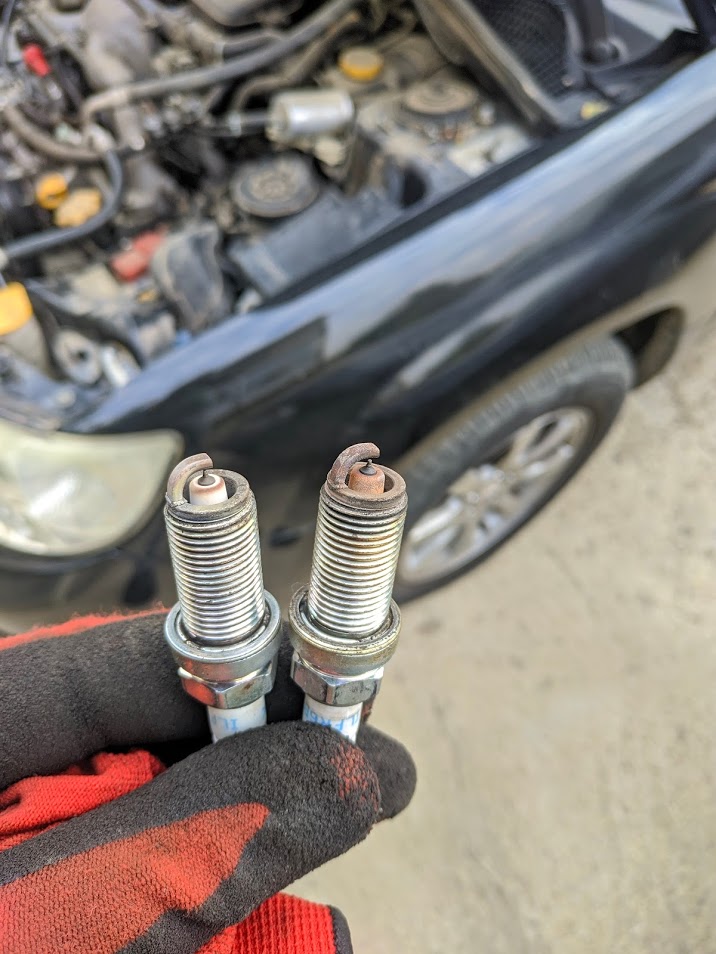

Hi gents!
I have a 2008 Subaru forester 2.0 L variable valve timing 158 hp.
I'm trying to diagnose a lean condition.
Around 7% at idle going to around 4% at higher rpm and under load. At idle I can feel a slight misfire and also in acceleration, in the low to medium rpm range mostly. Especially when it is hot outside.
Cylinder 1 spark plug looks clean like in the picture below (left). From my understanding it's lean afr and it's burning hot.
Checked for vacuum leaks for ages and I can't find any. Replaced spark plugs and coil.
I have 2 sets of injectors because the car is converted to run on lpg. Same behaviour on lpg. So the injector is ruled out.
Also when I unplug one of the healthy cylinder's injector the fuel trim goes to 29%. When I unplug the cylinder 1 injector the fuel trim goes to 26%.

I'm with Chad on this. The only other thing that comes to mind is a head gasket, which these are famous for. A leak down test would be nice here. You did a compression test, but I've seen them not sure up there, but show up on a LD test, especially if not done on a warmed up engine. I can't see the plug pic you posted to see if it looks clean.

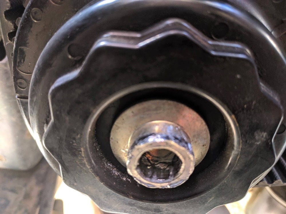

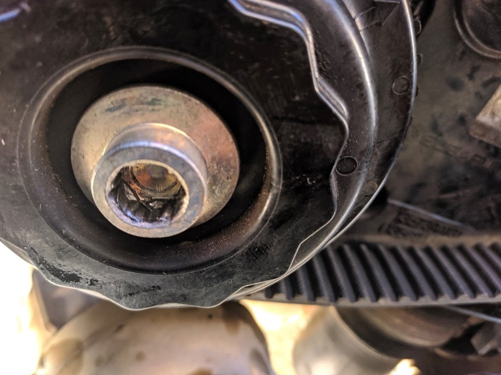

Update (maybe is of use for someone):
Like I said the valve lash adjustment on boxer engine is a hassle.
So it took 3 attempts.
You have to take cam sprockets out and they are held in place with this stupid design and weak metal bolt.
First attempt:
I got stuck at the stupid bolt. (this implies to take out fans and timing belt off)
Second:

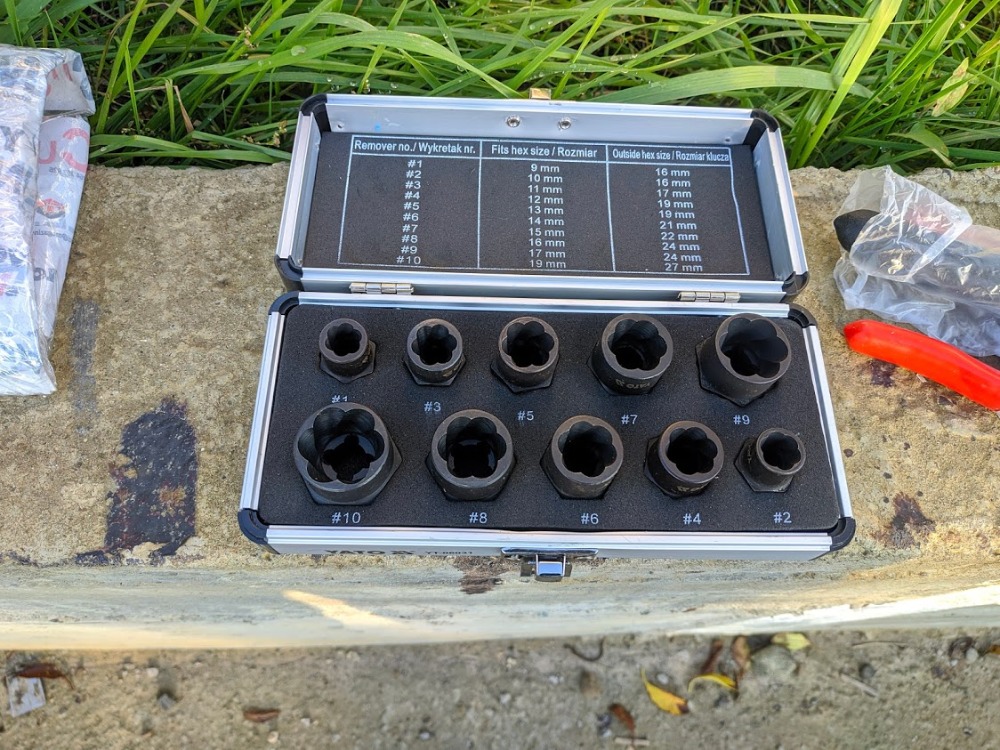

After I saw on the internet that it's a common issue and the solution is to use a striped bold extractor. So i bought this set
And of course it didn't help. Because the only size i needed was 18 mm and the set doesn't have it. Only chewed the bolt a bit.
So i took the timing belt again for nothing. But this time i striped the thread of 2 timing pulleys. Fun time.
Third time was the charm. I bought the 18 mm striped bolt extractor. Took out timing belt, cam sprockets, cams and the valve buckets.
I used a drill bit type of grinder on a drilling machine to thin out a bit of every bucket interior.
It seems that on that cylinder both exhaust valves were out of specs.
Tip - put something over the exhaust pipe under the valve cover. It will drip oil and it will smell for 2 months. And still does.
The engine works more smoothly. But i guess it needs a little valve lash adjustment on the other head too. Which i will do when the warm weather returns.
