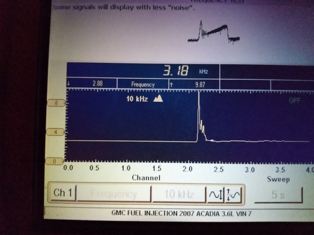

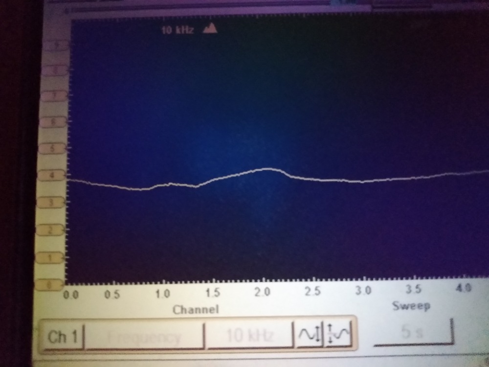

Surging at idle and other RPMs, app sensor throttle body and fuel pump tested good, there is a strange signal on the maf unplugged it and it still is surging, the only codes it had was a misfire on the number one cylinder, up to 480 misfires on the counter intermittently, also intermittently it would run rich at idle. I'm lost on this one can anybody please help me with direction to go.

5 years 11 months ago #44251 by Tutti57
Replied by Tutti57 on topic 2007 GMC Acadia SLT surging
Have you gone after that cylinder 1 misfire at all? Swapped coils or anything like that? Is it running rich at idle in both banks when it happening? See if you can determine if it's single bank related looking at fuel trims on both sides.

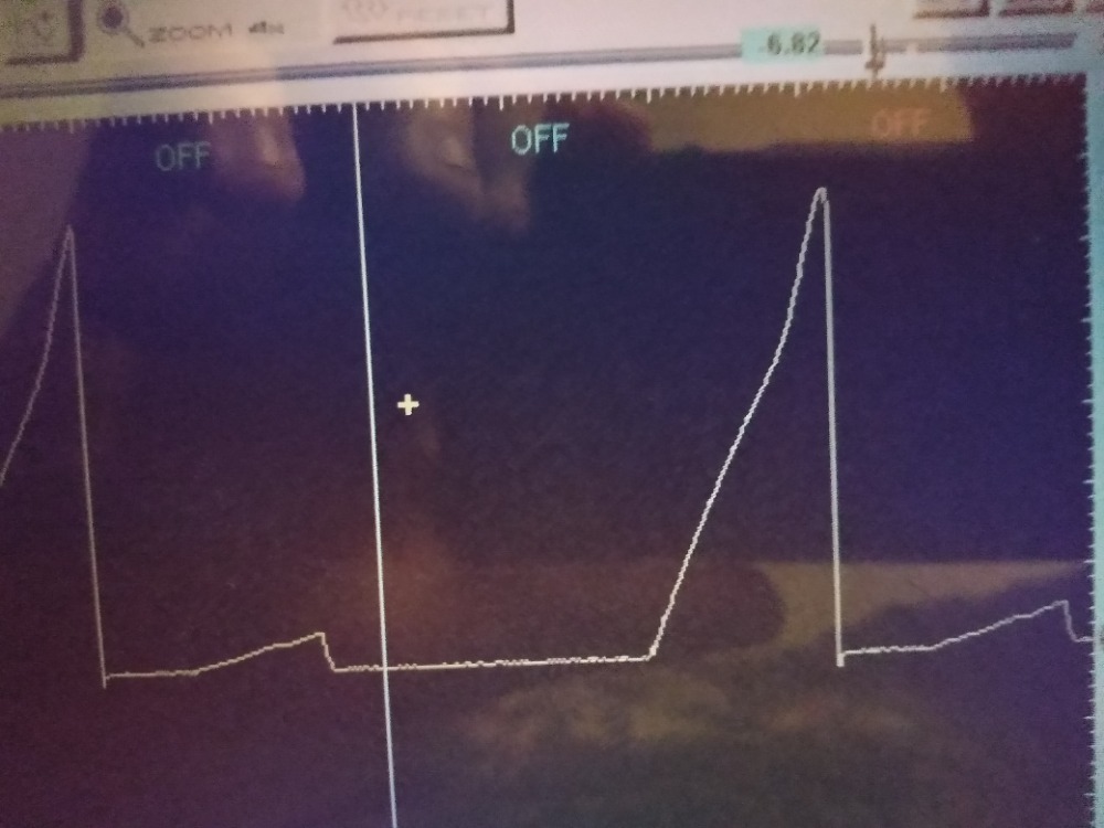

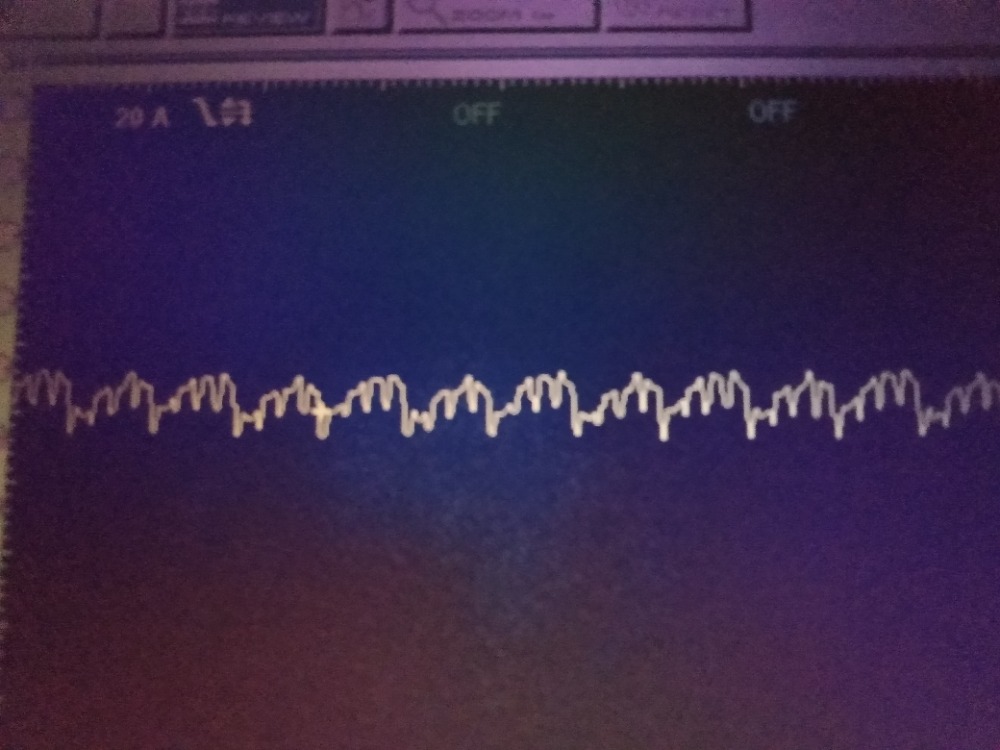

5 years 11 months ago #44364 by jerry r
Replied by jerry r on topic 2007 GMC Acadia SLT surging
Ignition amperage waveform on odd cylinders

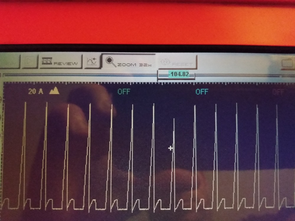

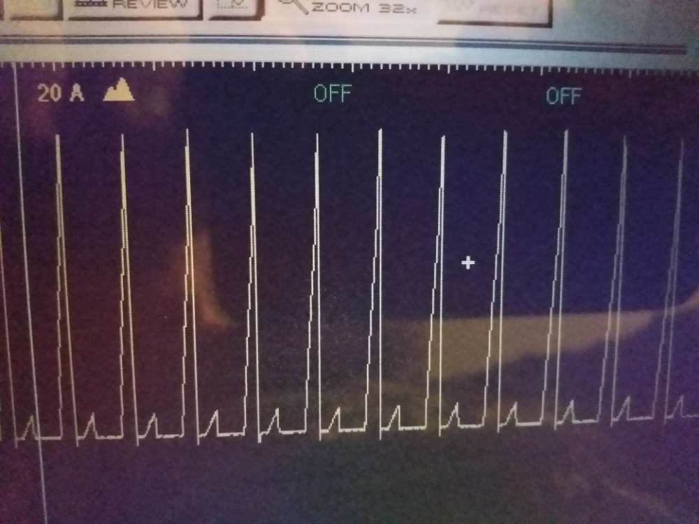

5 years 11 months ago #44365 by jerry r
Another waveform capture at higher RPMs

5 years 11 months ago - 5 years 11 months ago #44366 by jerry r
Yes I swapped coils and I did it primary amperage test. But still running rich on Bank one
