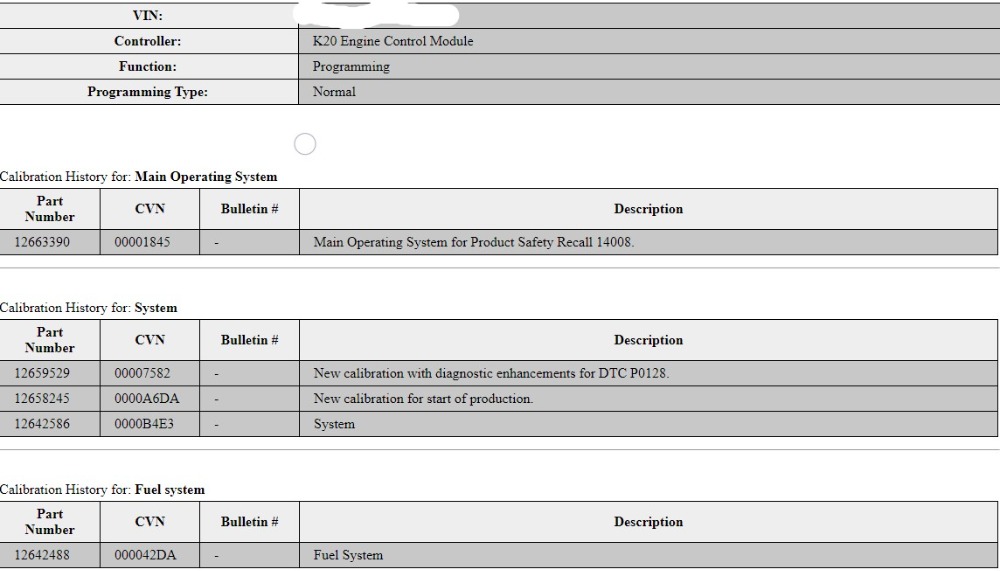

5 years 10 months ago #45344 by Tyler
Replied by Tyler on topic Pickup stumbles
Rapidrobert1 wrote: One question I have is whether there is any software updates available for this pickup. I went to a GM dealer and asked them about this. The service manager told me the software updates are only on the newer vehicles. He said there won't be any software updates on a 2008 Chevrolet Silverado 1500. Anyone have any knowledge on this topic?
It's possible for you to check this yourself using GM Tis2Web:
tis2web.service.gm.com/tis2web/
To determine if there's an update available, you'll need the VIN and the Cal ID's for the PCM. You can find these in Mode $09 in the Global side of OBDII. Navigate around in Tis2Web and you'll get a page like this:
Under 'System', the PCM has an update for P0128. Note that this only tells us what calibrations are available. ;) It's up to you to compare the Cal ID's to the Part Number on the left to determine what calibration you're at.

  • Rapidrobert1's Avatar Topic Author
5 years 10 months ago #45583 by Rapidrobert1
Replied by Rapidrobert1 on topic Pickup stumbles
I used this website Tyler. The website worked perfectly and there are a few software updates on my pickup. I talked to the dealership again and the service department said they only go back so many years on those software updates and my pickup is old enough where they couldn't do a software update on it anymore. None of the software updates on this pickup pertained to the problem I have. Thank you so much!
