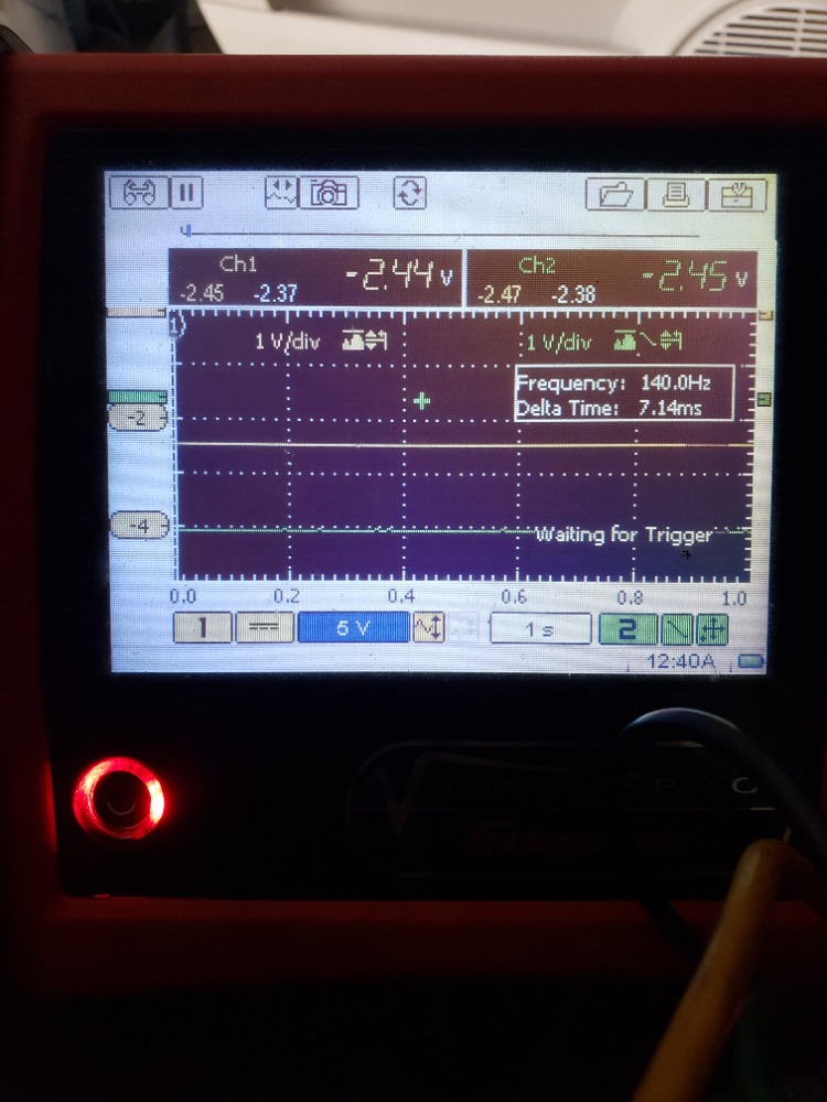

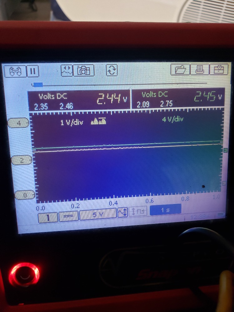

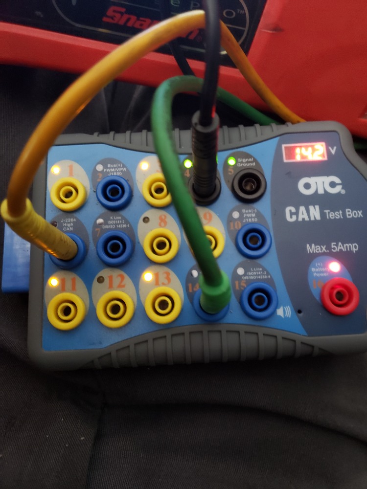

hey guys new to scopes and well new to the forum. I'm working in a 2006 dodge magnum with the 2.7 have a few u codes directed towards the air bag module. I have the scope hooked up with a break out box the leads are hooked to pin 6 and 14. But I'm not getting a signal I will post pictures any help would be greatly appreciated! Thanks in advance!

Oh and I have already unhooked the orcm as well.

Did you have a scan tool communicating with the vehicle when you were scoping the breakout box? If not that could explain no activity?
Also have you pulled those U codes from multiple modules or just the PCM?

I just ohmed out 6 and 14 and have 62ohms resistance. And I have u0020 which was in the ocm aswell as u1414 and u1415 codes

So that reading tells us that the main line is good. Has that occupancy module been replaced? Maybe it was not configured when installed?
What is th customer complaint on this one?

Air bag light was the main complaint. But the engine was recently replaced. When they replaced engine they said the tipm had issues. So they put a used on in. Well the put a used fcm in aswell not knowing they are two separate units. That's why I'm thinking its got the u1414 and u1415. With that being said any help on being able to configure the fcm?
