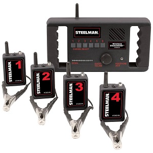

2007 Yukon Denali XL has a tapping/ knocking noise under acceleration. Engine is a GM Goodwrench reman. Had noise with old engine as well. Any ideas?

Is it Engine Speed related? Or, Wheel Speed related?

It seems to be engine speed related, but it will not do it while free revving the engine or brake torquing. Myself and 2 other techs thought it was engine related, hence the new motor.

Is the flex plate new or from the old engine?
I imagine if it was damaged you would have not transferred it to the new engine, but it could have been an oversight.
It wouldn't be the first LS engine with a cracked flex plate (flywheel)

Funny that you mentioned chassis ears. I was using them about the same time as you responded. The noise appears to be coming from the transfer case. Thanks everyone for the help.
