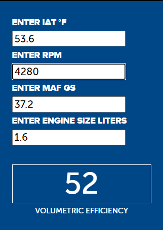

Also, at cruise I get a VE calc of 75%, but at closer to full throttle this drops to 52% - Does this point to an underreading MAF?

I believe you're also using OTC's VE calculator. Besides ignoring BARO, the math has been demonstrated to be wrong. VE, in this context, has no value outside of peak torque at WOT.
www.scanshare.io/Tools/VeCalculator

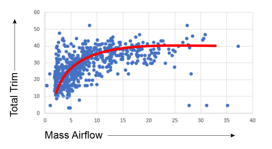

This picture might be the most useful. I made a scatter graph in Excel from your data. To the group, what do you see?
5 years 11 months ago - 5 years 11 months ago #44558 by Paul P.
I see an underreporting MAF.
Nice pic though, what if the trim wasn't scatter?, is this pic implying less FT correction at Higher MAF?

Weycraze wrote: Nice pic though, what if the trim wasn't scatter?, is this pic implying less FT correction at Higher MAF?
Trim is best thought of as a band or range. Using very specific values can lead to a faulty diagnosis. This vehicle is quickly reaching max adaptation so you see it flatten out quickly. Given the curve and the extreme correction, I'd want to get a WOT capture.

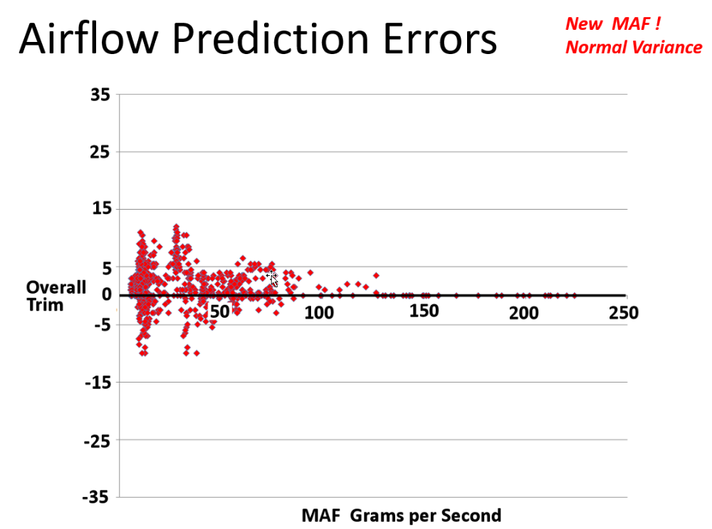

Here is a scatter graph of a vehicle that had the MAF replaced and trim cleared. It was then taken out on a test drive. The values flatten out when the system moves into OL operation. That region is zero because it hasn't had time to learn any LT values.
Note the large variation for the same airflow. Once again, this is a "fixed" system. This was part of an industry presentation I did about 15 years ago. Another thing to consider when looking at trim vs airflow is that the MAF output is not linear. It is more of an exponential and the most resolution is found between 0 and 50 g/s (rough numbers). That will affect the scatter graph as well

But Again, I'm looking at this picture and I see FT +-15 at lower Maf g/s, and at higher MAF g/s there is no Trim.; Are the scatter MAF or FT?
My Brain is not seeing the diagnostic value of this here. I always use Calc.LD and ABS Ld with trim and MAF pids to determine if there's an Air/or Fuel issue.
Could you please explain this in a lot more detail?

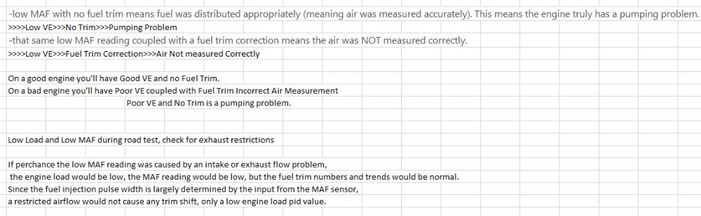

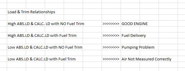

Weycraze wrote: I always use Calc.LD and ABS Ld with trim and MAF pids to determine if there's an Air/or Fuel issue.
How would I do this? just for seeing how trims relate to loading or..?

5 years 11 months ago #44589 by Paul P.
Some of my old notes to self lol!!!
This one came from Tyler,
Never stop Learning.

With an actual WOT pull in second, I saw more normal MAF values, and calculated between 85%-91% VE depending on which weather site I get barometric data from. I would expect this to be a decent calulator: atgtraining.com/atg-volumetric-efficiency-calculator/

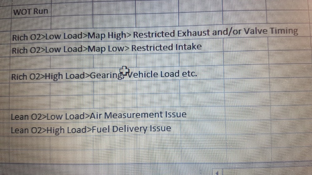

5 years 11 months ago #44762 by Paul P.
I just shared this with Chad, might as well put it here, its relevant:
It is a good guideline as well:
