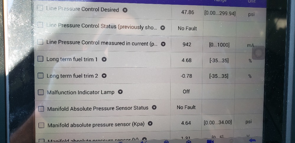

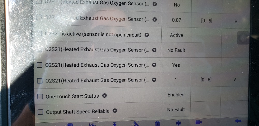

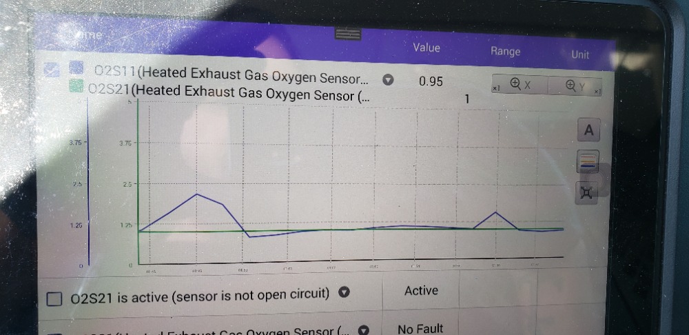

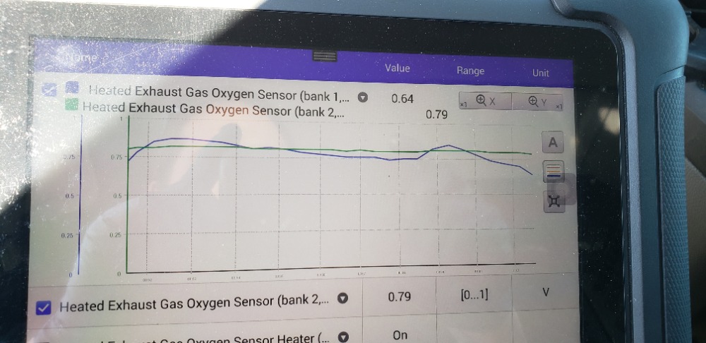

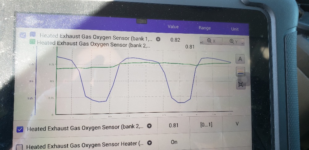

Im looking for help with a 2014 ford E-150 with a 4.6. Im getting catalyst inefficiency codes but when i look at the pre cat sensors they are dead on 1v. They dont switch. Ive replaced bank one sensor one but this sensor still sits on 1v. Both s1s2 and s2s2 switch constantly. This is my second day working on this.

Have you checked the voltage with a multimeter and compare it with scan data for the oxygen sensors stuck at 1 volt??
