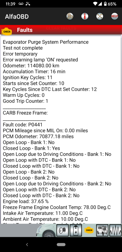

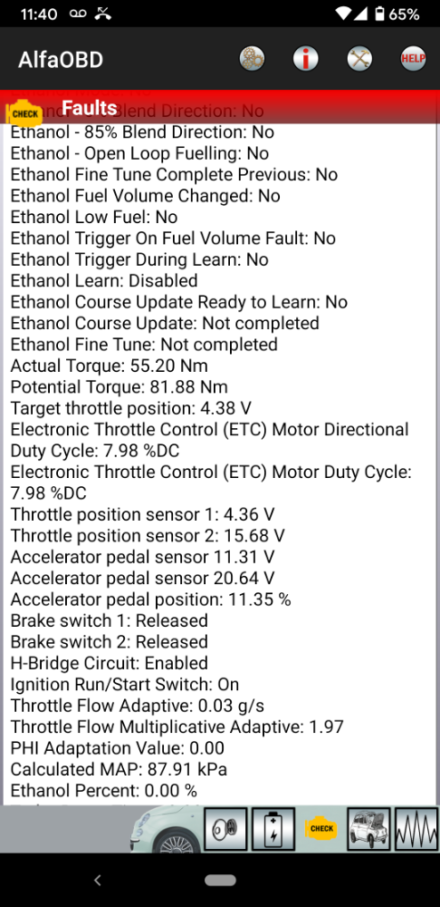

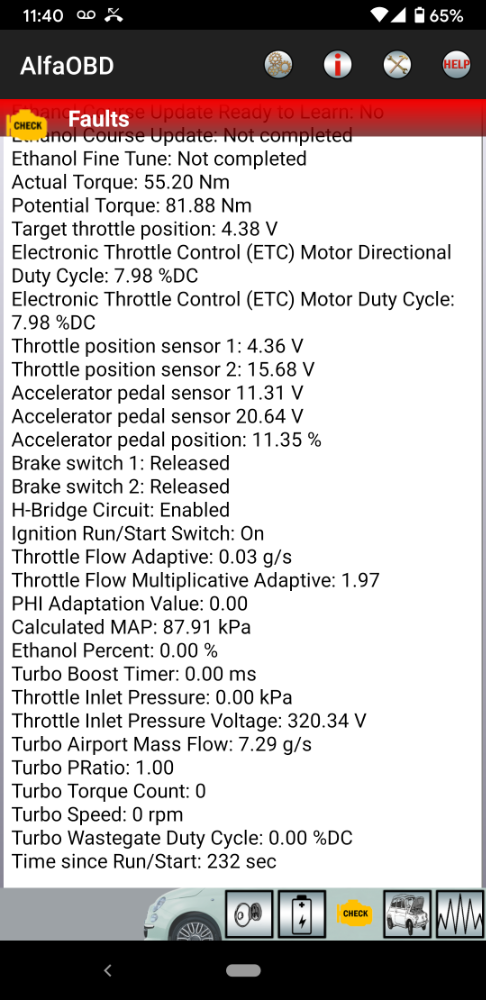

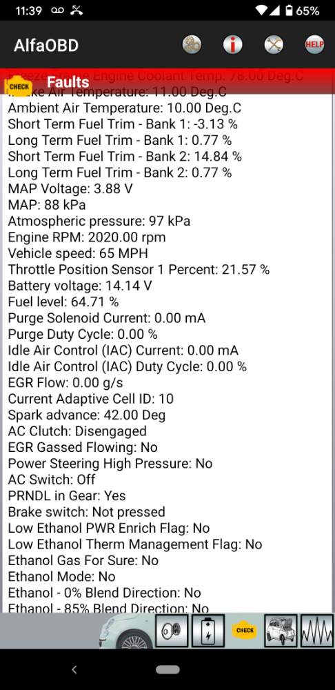

2016 Jeep Renegade trailhawk 2.4l No noticeable symptoms. I keep having this code pop up intermittently, and I'd like to get to the root cause of it. I understand it has to do with the evap system, and possibly the purge solenoid, but I'd like to be sure before just replacing stuff.
I've attached the freeze frame data from AlfaOBD
