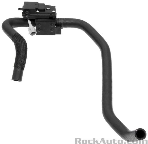

Does this look like the valve in question?
I was trying to get an idea of what kind of gear ratio it uses to turn the valve, but I can't really tell from pictures. :silly: Thought that might give us an idea of how long it takes to move the valve.

Yep, that's the one. I have not bled one of these with my vacuum tool since I've gotten it, so I'm not sure, but I think I would do koeo with heat on 90* to make sure the valve is open. Using the coolant funnel set up can be tough with these. We will usually try to lift the front of the truck up while doing it. I got the vacuum tool for these dang things and haven't needed it yet cause we don't see a ton of them. Same set up on the titans.

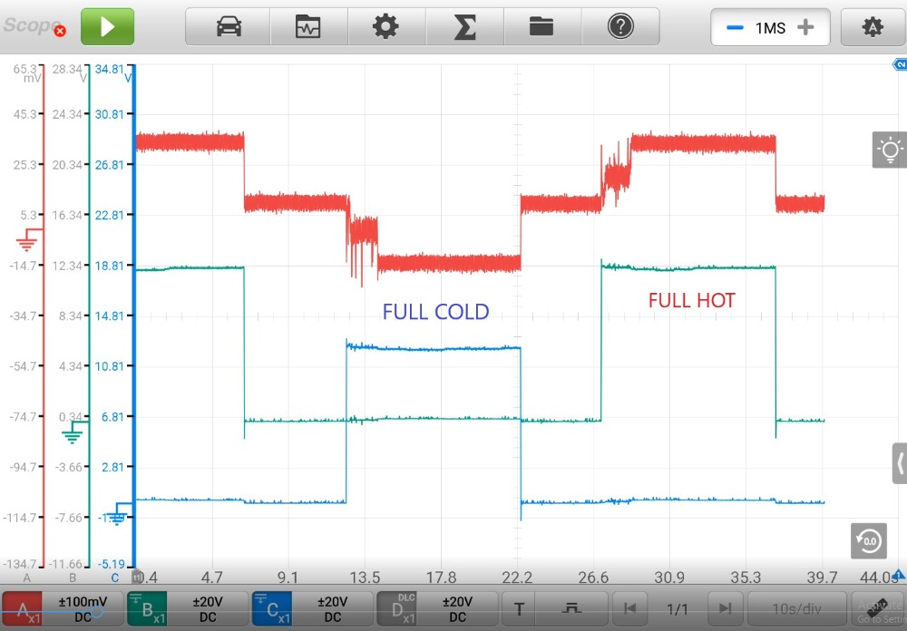

While I had a '12 Armada in for wheel bearings, I took the opportunity to check out the heater control valve. The valve itself looks to be slightly different? But the general design is probably very similar.
Red is motor current. 100mV/A. Blue and green are the two wires at the motor connector. This motor doesn't draw nearly as much current as I thought it would?
Here's zoomed in on the current waveform:

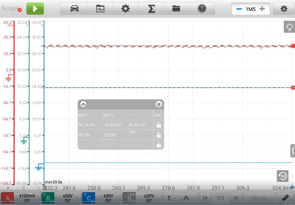

Steady state, the motor draws around 340mA. If you're substitute load testing this motor, something like a headlight would be way too much. :lol: A 194 bulb would be perfect.

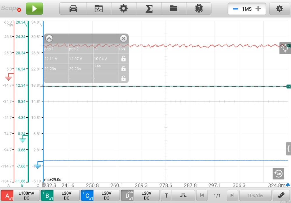

Here's voltage on one of the control wires with the motor turning:
12-something volts. Took this with the engine running. Not sure if that makes a difference? :huh:

Your 12v makes sense I guess, since the battery would probably be around 14v running. Mine at 10v koeo had 12v, so the same 2v difference?
