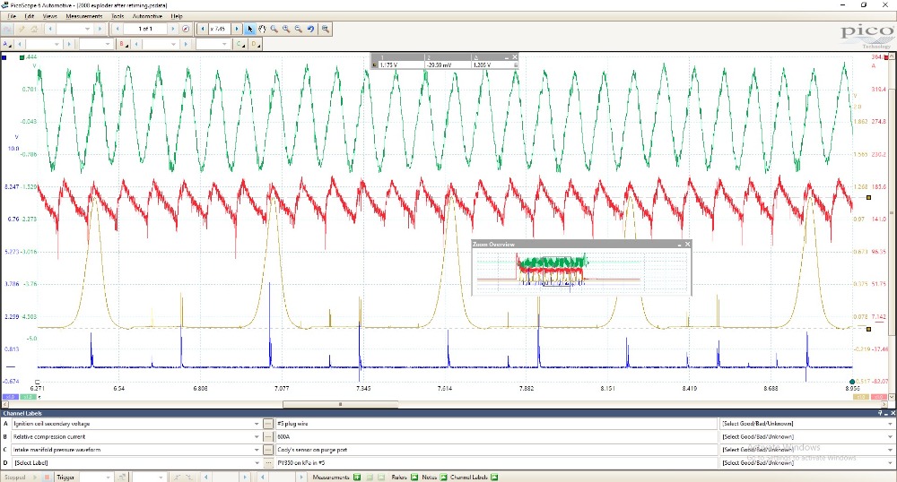

I looked at both banks .ps files Tyler provided and I see retarded Exhaust Both Banks.
This would help explain higher running compression than the cranking compression.
Running compression is supposed to be less, this engine has more!!!
I would want to check 2 cyls per bank in- cylinder to ultimately prove retarded exhaust both banks.
But, based on the captures, and being SOHC, lash adjuster and cam lobes can APPEAR to affect timing.
A tight valve will open early and close late, increasing duration, whereas the loose valve will open late and close early, decreasing duration.
Try and fill a Pico screen Tyler to get consistent data, that wasn't really enough data in both of those files.

Matt T wrote: I was thinking the vacuum pocket at the start of the intake stroke looked like a late IVO on both banks. And there appears to be a ~15* difference between the bottom of the pockets.
I see that, now. And, I agree.
I can see late EVO and late IVO. ....But, I just don't see IVC as late, at all. :unsure:
Does anyone have access to a 4.0L to grab a known good? I'll try to find a cam chart.

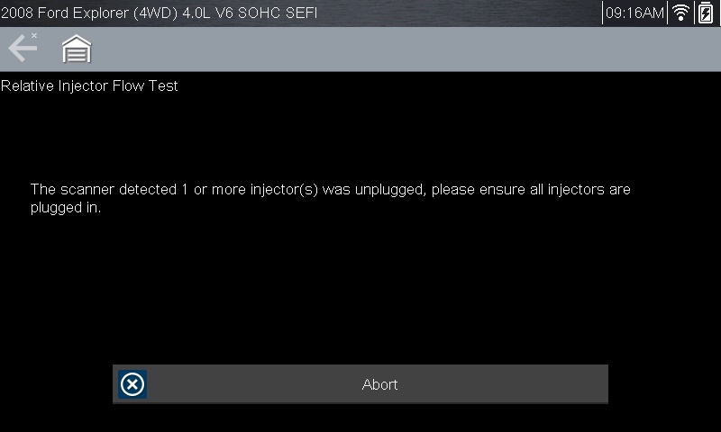

So, broken wire in the injector pigtail, right? Nope! I open up the harness and find the #4 injector power feed wire shorted to the control wire. :ohmy: The insulation has just, I dunno, crumbled? Copper to copper. I'm taking the intake back off to open the harness further to see who else might be damaged.
Anyway, I'm bothered by the behavior of the PCM. Making and breaking the short never set a P0204, never showed on the INJ_FLT PID and (for now) didn't appear to damage the injector driver. You'd think if the PCM was shutting a driver off to protect itself, it'd code.

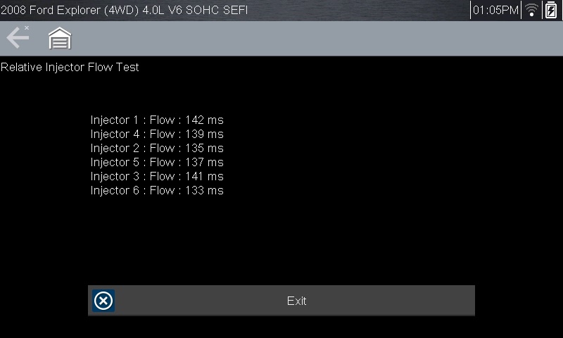

What's weirder is the behavior of the automated injector balance test. When you attempt to run the test with the wires shorted, you're presented with this error message two injectors into the test:
After temporarily separating the wires, the test passes like normal:
Clearly, the PCM is detecting a problem. I guess the detection logic for P020X doesn't provide for a direct short to power? :silly:

Tyler wrote: What's weirder is the behavior of the automated injector balance test. When you attempt to run the test with the wires shorted, you're presented with this error message two injectors into the test:
This part does make some sense. The problem being detected is probably no flow on the second injector, which appears to be #4 judging by the way the results are ordered. Scan tool reporting it as the injector being unplugged for whatever reason.
And FWIW I don't know exactly how the test works. Could be the PCM is just reporting data and the scan tool is what flags the result as a problem??
Oooooh, now that's a good thought. B) I wonder if installing a test light across the injector and running the same test would show the same error? I may do that next week.
Same. I've always wanted to investigate more into what is actually taking place during this test. I also don't have an IDS/FJDS subscription to compare to.

Tyler wrote: Oooooh, now that's a good thought. B) I wonder if installing a test light across the injector and running the same test would show the same error? I may do that next week.
Something like a tail light bulb should keep the PCM happy electrically.
You could 'scope injector current and fuel rail pressure while running the test.
Also IIRC Forscan will do injector balance.

Here's the after cranking waveform of the Exploder. #5 sync, RC, intake pulse and #5 in-cylinder.
