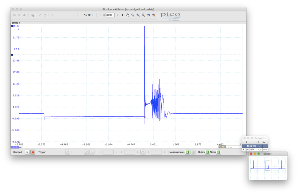

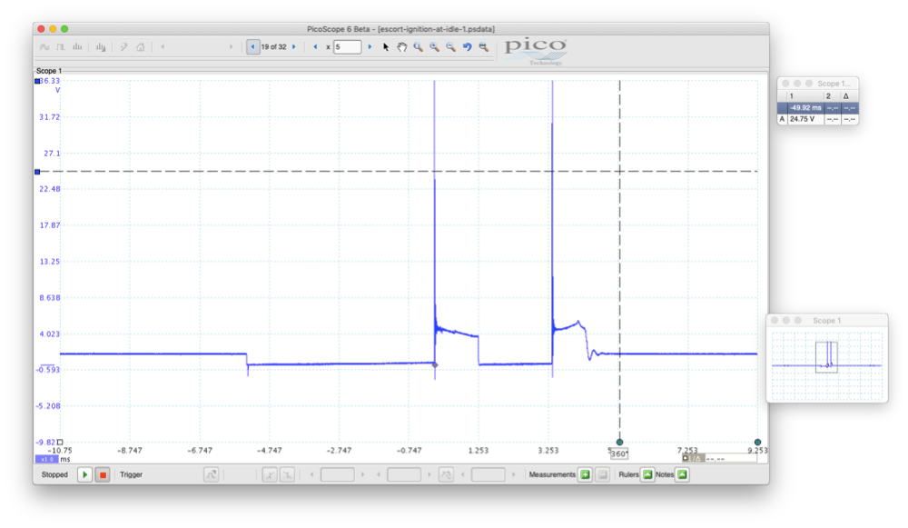

I have checked all around the engine using the water test and also attempted propane. I can't hear any change in idle with either of these tests. I have tested by disconnecting all of the vacuum lines that I can find from the intake (and plugged them) and then checked to see if the short term fuel trim goes negative, and I don't see any difference. I have looked at the ignition primary with my picoscope. One thing I don't fully understand is how the waveforms should look with a throttle snap. They look different under a throttle snap than at idle (aside from the double firing that Ford does at idle). I'll attach screenshots of it when I did the snap throttle and at idle.

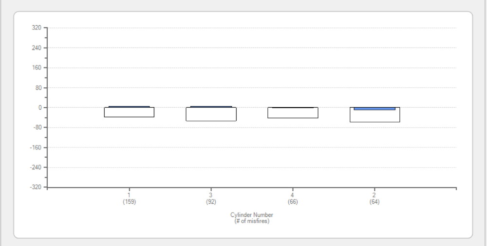

5 years 11 months ago #44790 by chris.campbell
Replied by chris.campbell on topic Ford 2.0 SOHC random misfire
I don't see a mode 6 option in my software (Hickock NGS), but here's a screenshot of the power balance, which counts misfires. As you can see, misfires show up on every cylinder if I let it collect data for a couple of minutes.

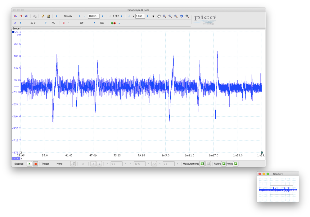

  • chris.campbell
  • chris.campbell's Avatar Topic Author
5 years 11 months ago #44837 by chris.campbell
well this gets interesting. here's an A/C ripple check. i don't think this looks good. next is a driving test with the alternator disconnected.

5 years 11 months ago #44866 by Matt T
Replied by Matt T on topic Ford 2.0 SOHC random misfire
That alternator trace looks like something is pulling voltage down pretty hard. Might just be the alternator or could be something else.
