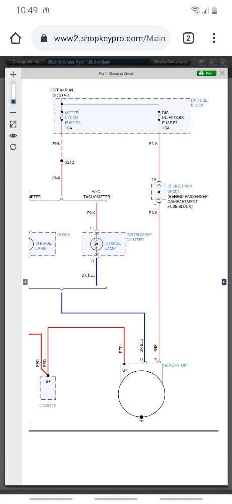

2006 Chevy aveo
  • Chevyman
  • Chevyman's Avatar Topic Author
5 years 11 months ago #44926 by Chevyman
2006 Chevy aveo was created by Chevyman
I have a 2006 Chevy aveo. With a charging problem. I'd like to full field the alternator to make sure it's not the problem. Isn't the voltage regulator separate and not in the alternator itself. Any help would be appreciated.
5 years 10 months ago #44953 by Noah
Replied by Noah on topic 2006 Chevy aveo
Looks pretty simple. If there's power on the pink wire and the and large B+ wire, and the alternator case is grounded it should charge.
